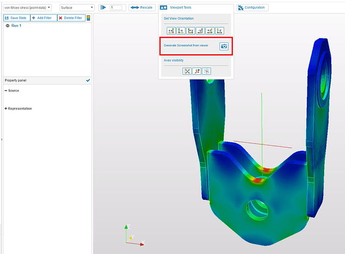

When you are using SimScale’s online post-processor, you have the possibility to take a screenshots of your results which will be saved in your project.
To take a screenshot in the post-processor, go to Viewport tools and then Generate Screenshot from viewer

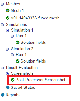

The screenshot will be saved in the project tree

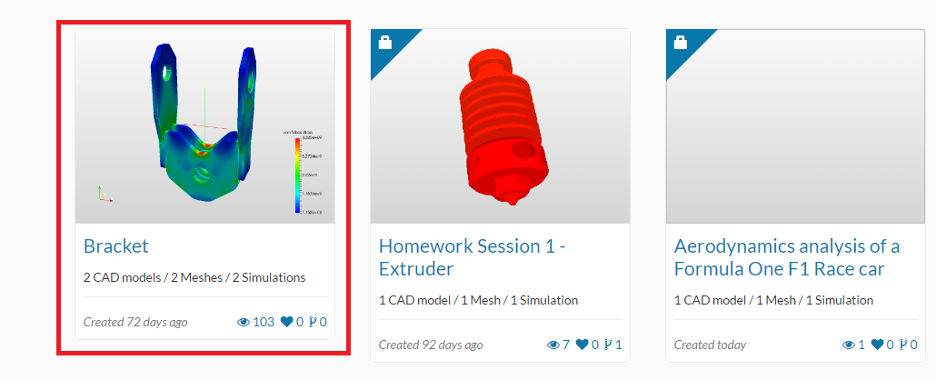

You will also notice that you 1st screenshot becomes the thumbnail of your project in your Dashboard and in Public Projects if you are a Community User
Any idea why the screenshot function doesn’t always work? After I took one, I had to go to Screenshots, look at it, then go take another. I could not just take a screenshot, move the view, then take another.
