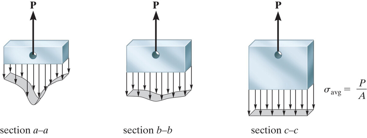

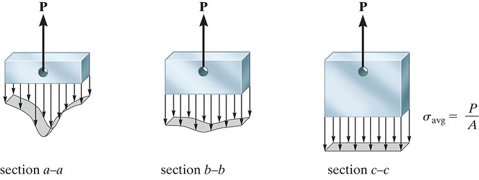

According to Saint-Vernant’s principle, stress concentrations even out when one moves away from where the force or boundary condition is applied. A good estimation to assume the “flattening” of stress peaks is one critical dimension, which in case of a rod or pipe is the diameter of the rod. This is shown in the figure below, where the critical dimension of a rectangular rod is the diagonal of the cross-section:
