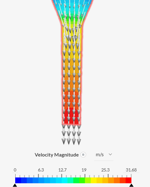

Taking a quick look at your project, with the boundary conditions assigned, the velocity at outlet seems to be as expected, directed outwards of the flow region:
Did you already make some changes to get these results or do you mean something else when you refer to negative exit velocity? Please let us know! :slight_smile:

It is actually the expected and correct result. When you look at a directional velocity field like Velocity Y then you see the values with respect to the orientation cube direction:
Since the Y-direction points upwards, and the velocity vector downwards, you see the negative sign on it.
