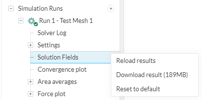

You can download your results by going to “Solution Fields” and then downloading the results from the context menu. You can use ParaView to post-process your data locally on your machine.

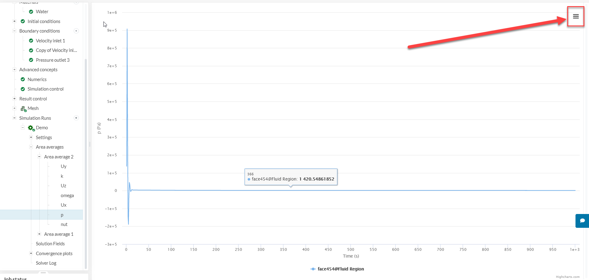

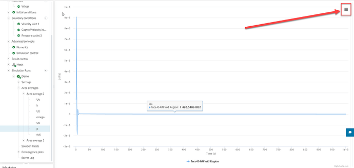

Also the plots can be downloaded in various forms, after you click on the icon at the top right of the page.
