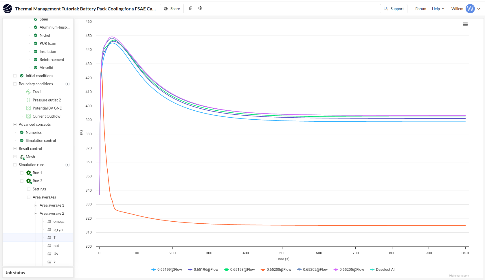

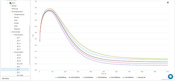

T (Average Area 2, Expected):
T (Average Area 2, Current results):
Overall temperatures are higher and there is an unnatural swing in 0:65208@Flow

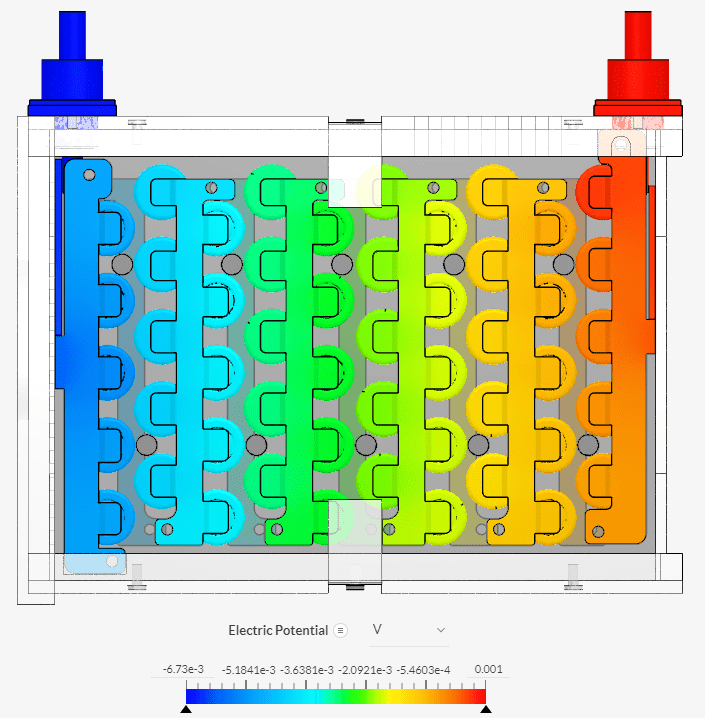

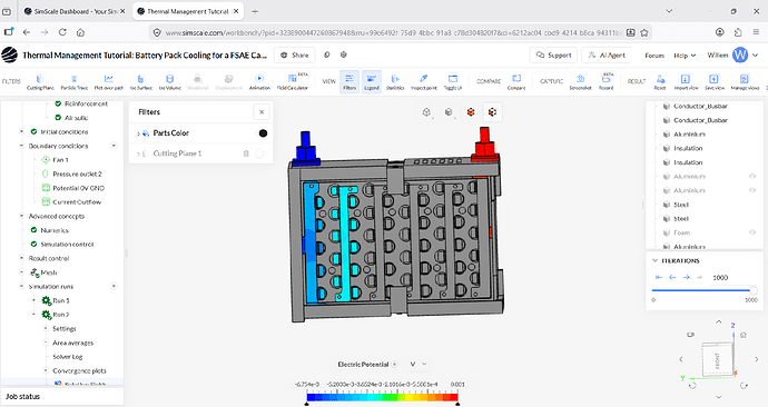

Electric Potential (Expected):
Electric Potential (Current Result):

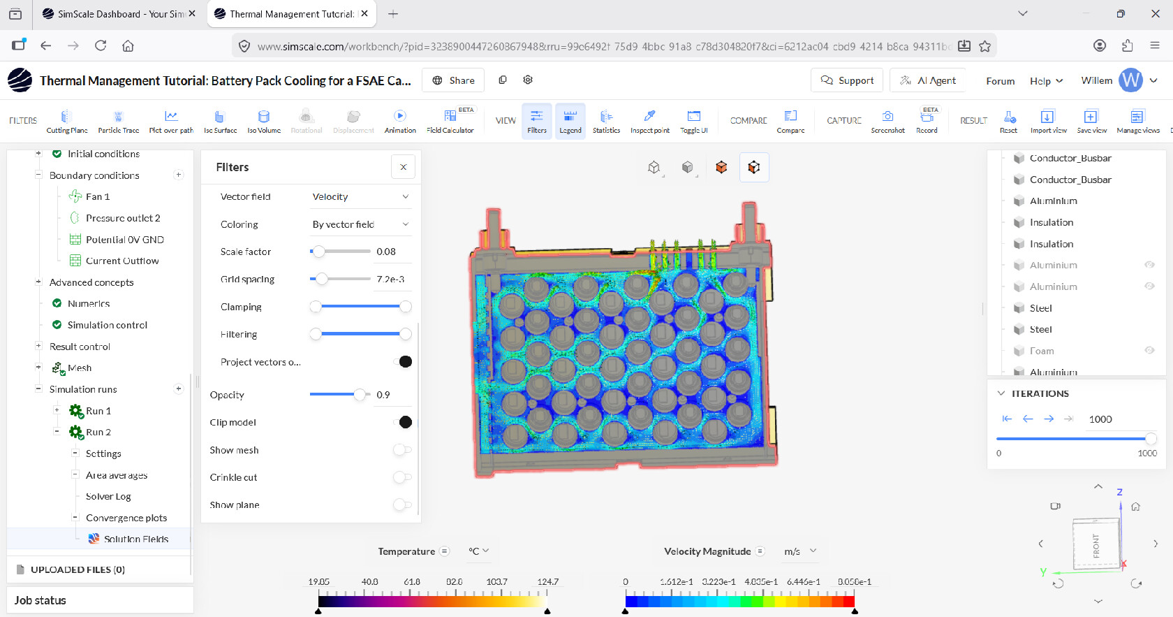

Air flow (Expected):
Air flow (Current result):

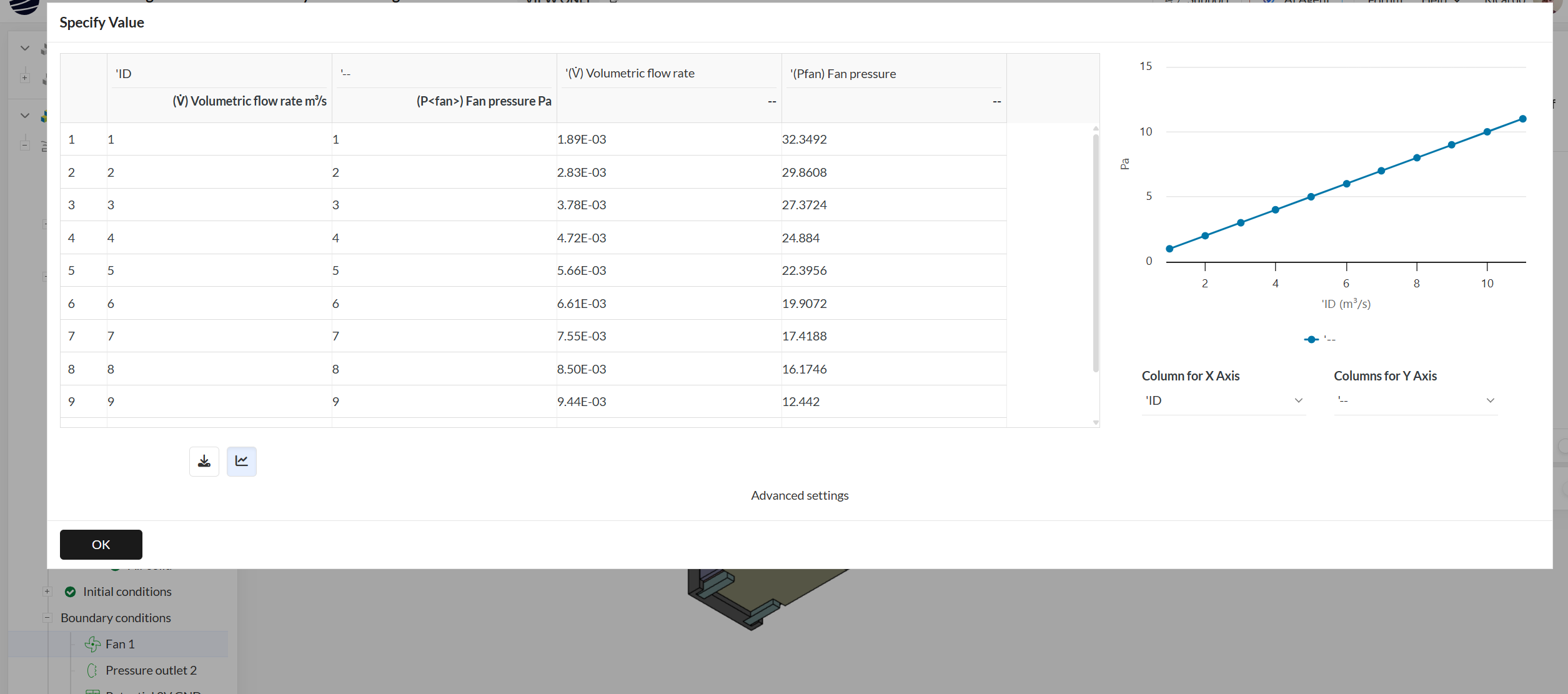

Your fan boundary condition table definition looks weird in comparison to the tutorial. Here is what you have:

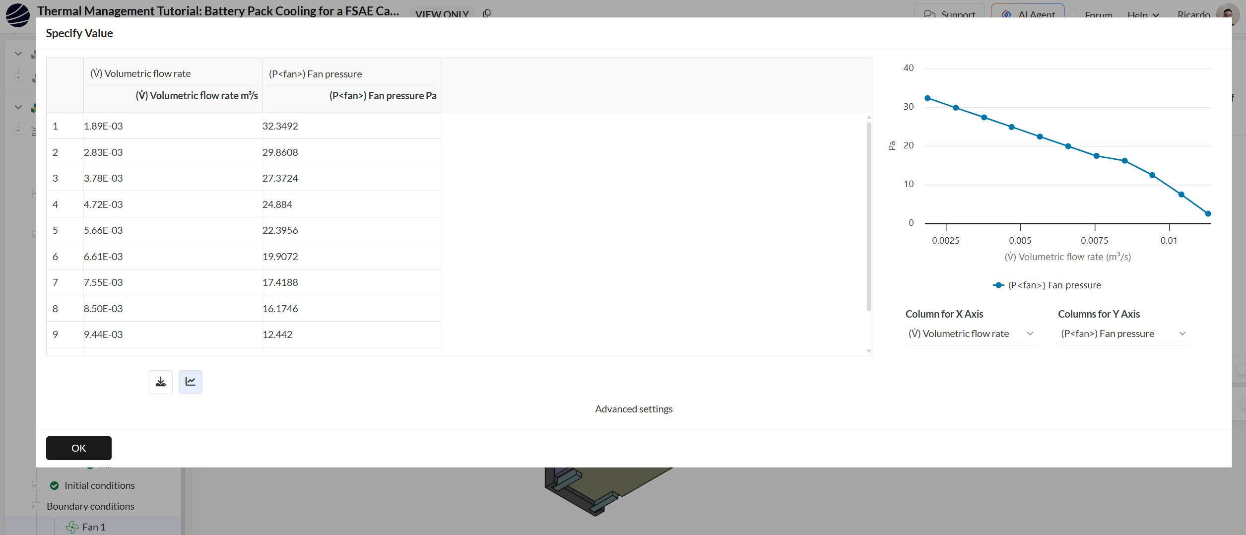

Here is what it is supposed to be:
