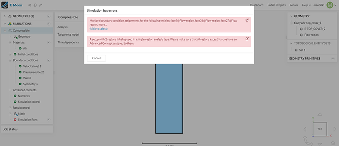

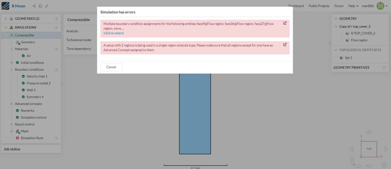

The first error message indicates that some faces have more than one boundary conditions assigned to them, which is not allowed. You will have to review your boundary conditions.
The second one is an error that you get when you do not remove the solid body after you create the external flow domain. Only the flow region should be present for a compressible analysis. You can delete the solid body in CAD mode.
B Moon Has error in run simulation

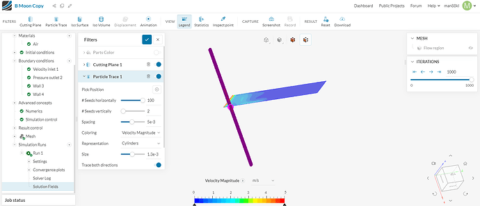

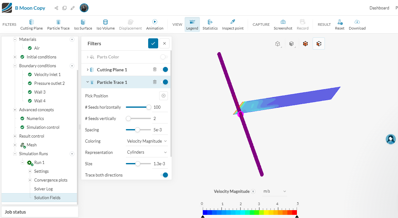

But ‘B MOON copy’ no error in run simulation, only cannot plot stream line diagram, please help
B MOON copy in below link

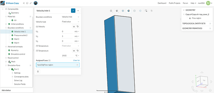

As mentioned above, unless you recreate the run with the correct Velocity inlet, you will not be able to create the streamlines :slight_smile:

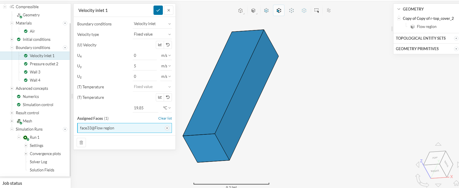

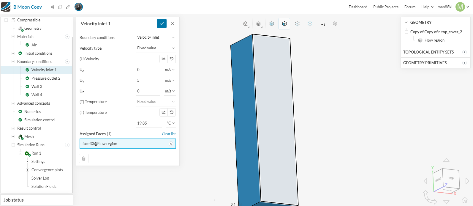

I changed Uy to be 5m/s
Would you please updated in my project directly and make sream line diagram for me, please?
Great, but you also have to create a new simulation run.
