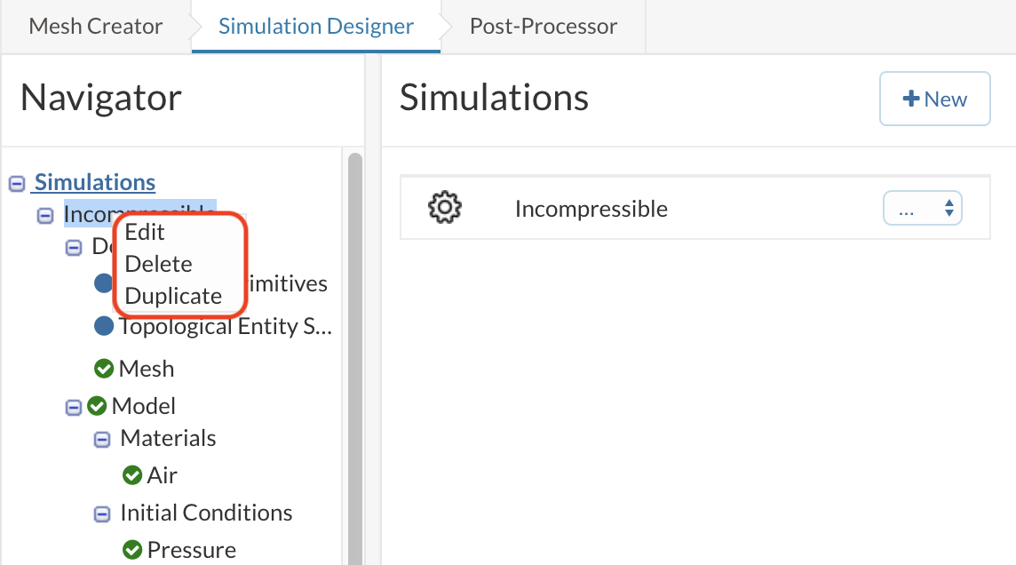

Is there a way wherein I can copy a previous existing simulation, say second one, and replace the front wing with my geometry? The STL file of the model is showing error in opening.

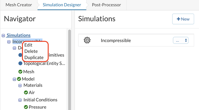

Yes this is possible. Right-click on the simulation and Duplicate. See the picture below.

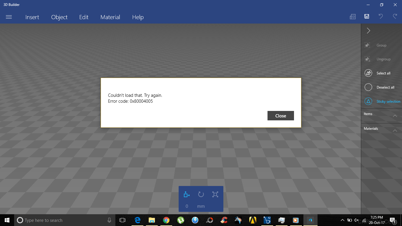

I designed it in SolidWorks, exported it to STL and merged it with the model manually with an editor. However when uploading the geometry first it seems that all the geometry is loading but then the car disappears and just the frontwing is there.
I realised that there is a problem with the car geometry, because as i try to open it, it says āa facet normal problem was found on one of the facets. Check your STL fileā. Maybe you can provide a new car geometry, if this is really the problem?
I tried around many different ways but it always ends up with the car disappearing,
Any suggestions how to solve it?
