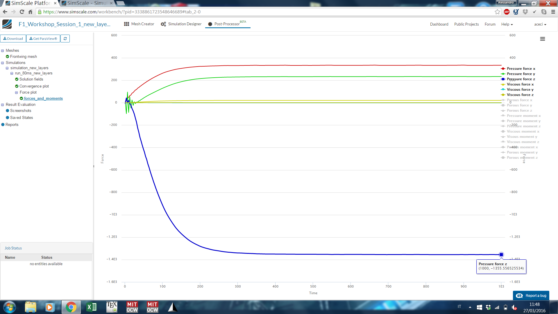

I haven’t had a chance to study what the setting is really doing, but I did change the finalLayerThickness setting from 0.3 to 0.9 like Maciek mentioned a few posts up and now my results look correct.
Results
I don’t why I needed to do this since it seemed to work for Malik and others with the 0.3 setting?
I changed the yplus settings and now my results are like yours, here there is a screen!

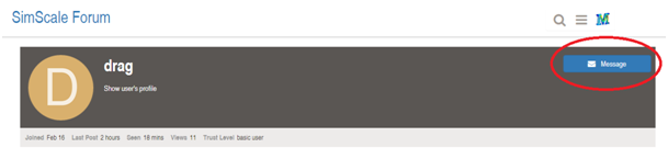

One more thing: as far as I remember an official and the only language at this forum is English, so please follow the basic rules. And if you want to send me private message use this option on my account:
Also, this sentence in Polish has no sense to me.
