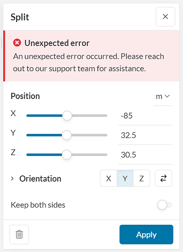

When I attempt to apply my split body it comes up with an unexpected error saying “An unexpected error occurred. Please reach out to our support team for assistance.” Does anyone know what I can do to get past this?
Hi @TheArchinator,
Thanks for posting your question. It seems to be an issue with your CAD file. Could you please share the project link here by any chance?
best,
Sorry I probably should have taken the question down by now, I managed o get past this by simply changing the units on the split tool from meters to millimeters and moving the plane into position. This probably worked because the actual body was in mm.
