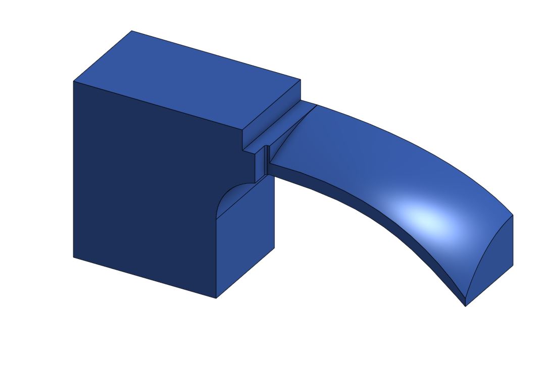

  1. Did you thing, to cut the model at this point, will decarease the caluclation duration ?
    i think at this point the downwater has no influnce to the upperwater, because of the velocity and the gradient of the arch.
  2. May get ap1 (Water) in the arch, as subdomain with a cylinder ?

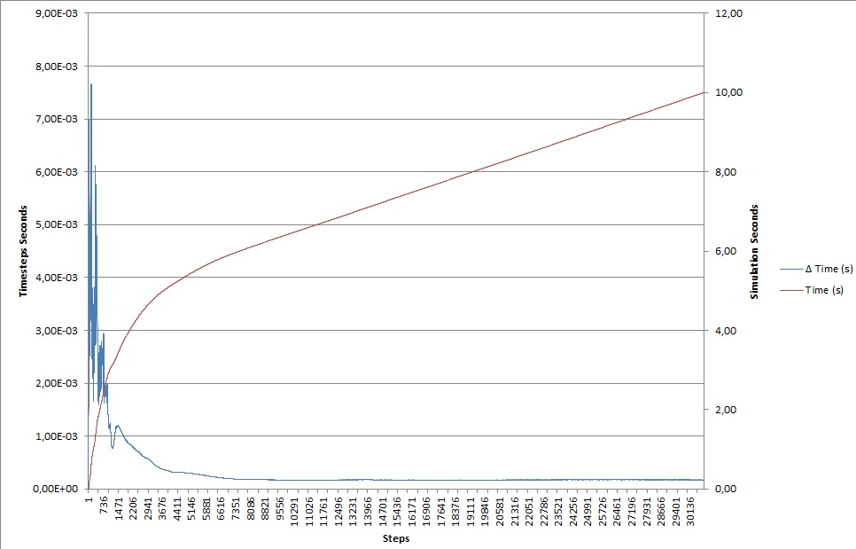

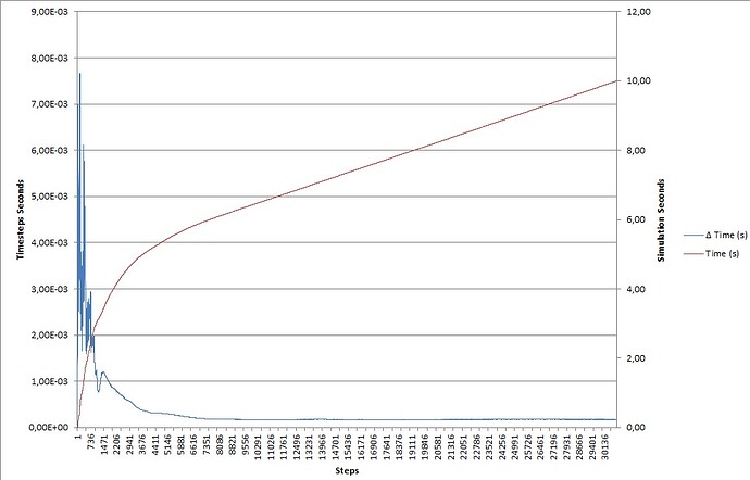

I made a chart, with the delta t of each time step and the runtime.
The deltaT places itself at < 2.5e-04 seconds, may is it possible to increase it ?
Is the timestep only based on the courant value ?
