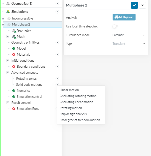

Hi @whuaman
in case you couldn’t find the solid body motion option in the link that @jousefm shared you can look at the img below
Thanks
Ani

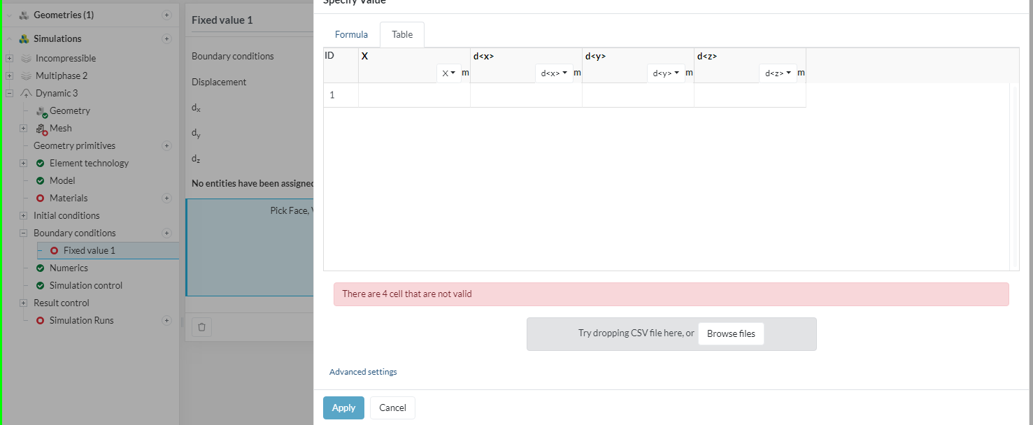

Hi @whuaman
You can use dynamic model to perform this simulation. There you can import the distance v/s time file…here is the screenshot of that option to make things clear.
Thanks
Ani
