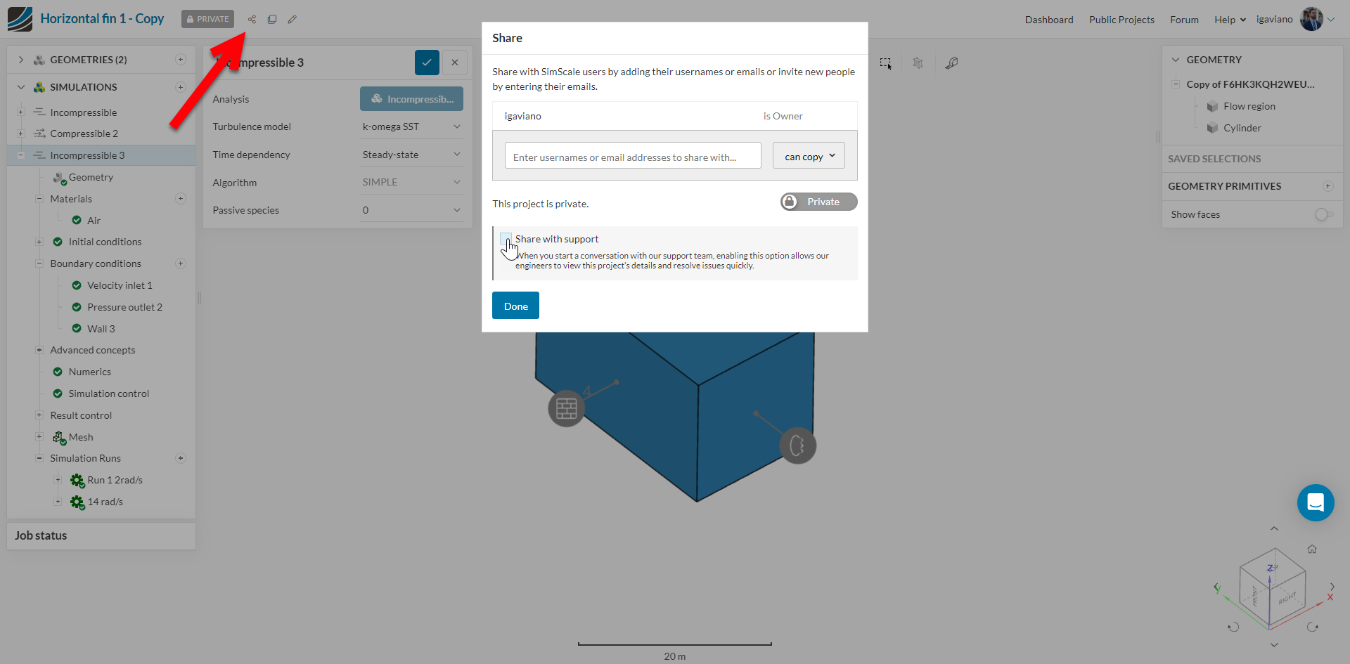

It would be better if we had access to your model to give better advice. To do that, just copy the link to your post and edit your original comment with it. In order for us to have access, just click the “share button” and “share with support”
