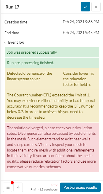

  1. The first one is composed by a big cube where inside is represented the piece as a cavity (the cavity is the piece that is about 600 ºC) but I can’t select the cavity as a different solid material from the entire solid.
    URL: 1.1 Cast test - Two pieces and enclosure by ss_garcia | SimScale

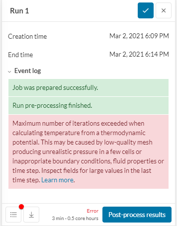

  2. The second one CAD model is composed by two solids: a small, thin cube inside another one bigger. Both of them are two different CAD files.
In the first case I want to know why when I am trying to simulate a 1000 s or 500s end time simulation, it go on so slowly (a simulation can last 8 hours or more…) or why it stops at midrunning with an error of divergence.
In the second case I want to know why the simulations ever stops and says that “Maximum number of iterations exceeded …” when I have checked the mesh and the problem can’t be flow conditions (there aren’t flows)

Case 1 error
Case 2 error
