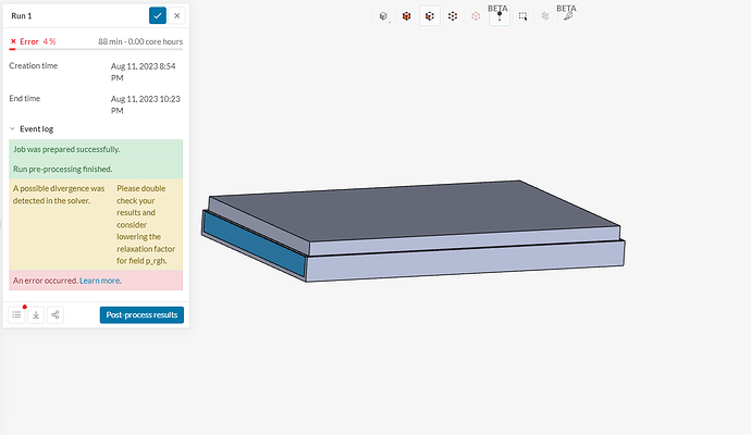

Hi i encoutered this problem while simulating my simulation in which i created flow region under the solar PV and the result is error. hope someone can help me with this problem . thank you

Hello, the iterative process is diverging due to poor mesh quality.
It would be a good idea to remove all the tiny fillets around the model (around 1.5e-5 m in size) and inspect the mesh quality before running an operation.

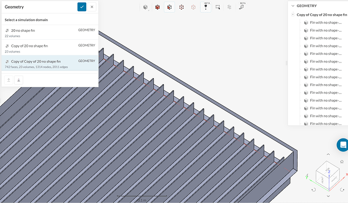

Hi want to ask i already increase the mesh, still error in the simulation. Please help with my problem

From having a look at the mesh, the quality is still very poor, which is likely causing the simulation to break. Please double check the link in my previous message.
PS: the small faces that I mentioned in the previous message are still there (in red):
You will find similar faces on the other side of the model as well (negative x).
