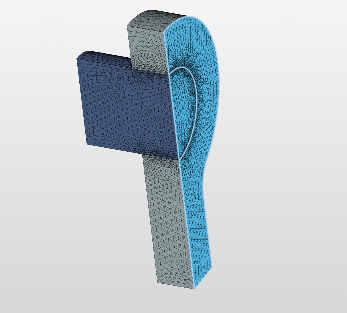

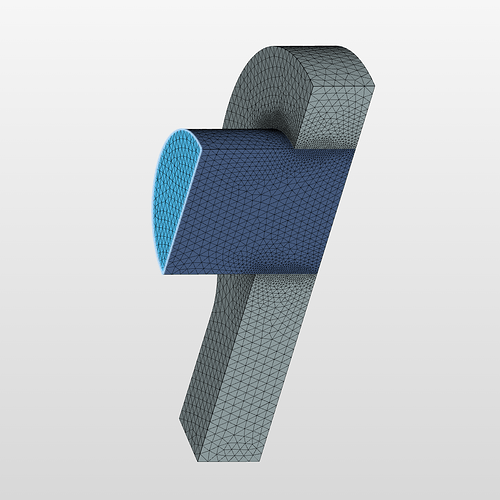

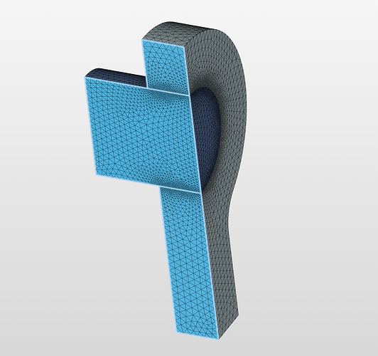

please check your z-symmetry again and the y-symmetry like you defined it is not necessary. I would additionally cut the model into halves along the x-z-plane and then define the y-symmetry at the faces where symmetry was taken into account.
\underline{\textbf{Fixation}}
\underline{\textbf{Y-Symmetry}}
\underline{\textbf{Z-Symmetry}}
Tell me if that worked and if there are any further questions.
Re simulated with the modified geometry as you suggested but same problem occurs
