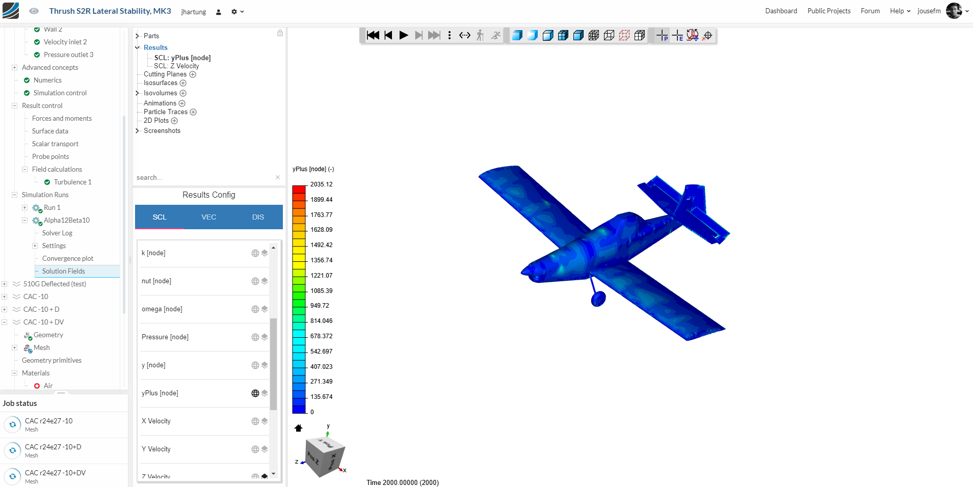

Hi @jhartung!
Am I missing something here?
Please let me know if I just do not get it but for me yplus shows values along the entire plane.
All the best!
Hi @jhartung!
All the best!
Bizarre. Yes it’s working fine for me as well. Perhaps I didn’t have the scaling set properly? Apologies for sending you on a wild goose chase.
While I’ve got you, does this look normal or should I consider a thinner first layer for lower y+ values? I’m seeing regions slightly above 300.
