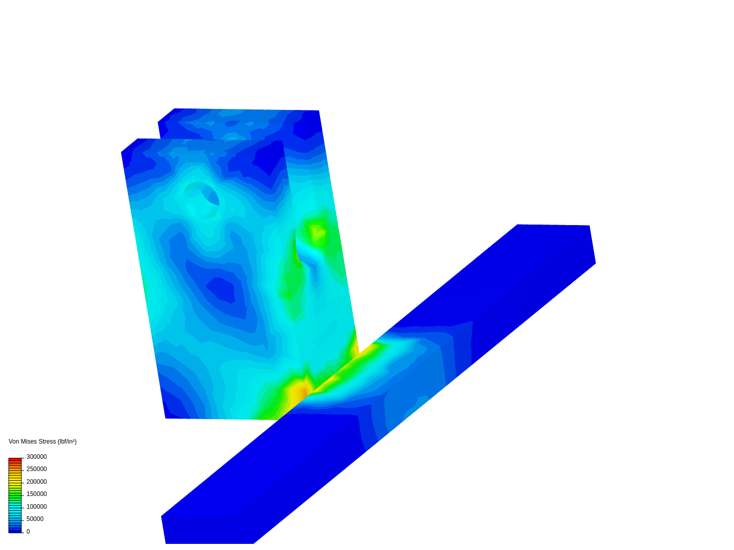

I have created a similar analysis to the iPhone drop test and it (finally) completes it, but no impact happens, no stresses are developed, nothing moves. There’s probably a single setting I’m missing, but I can’t figure it out. It is called “Hammer impact 1”:
Any help or advice would be appreciated.

Hi @pjbirt,
the results look totally fine for me! I guess you are just missing the proper setup in the post-processor, I tried to highlight the relevant ones here:
Thanks. I missed a few clicks I guess.
