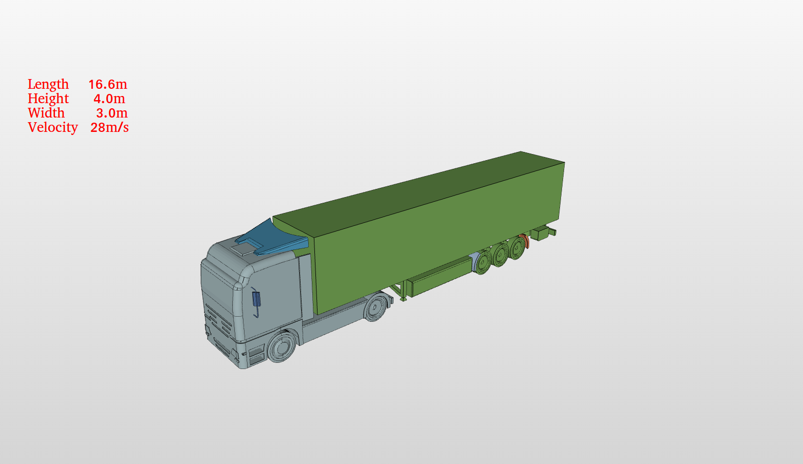

Example
To simulate air flow around a truck with given dimensions and velocity
First we will calculate the Reynolds number.
Since this is an external flow simulation so
Characteristic length = 16.6m (length of the truck)
Dynamic viscosity of air = 0.0000186N.s/m^2
Density of air = 1.19198kg/m^3
Inlet velocity = 28m/s
Re = ρvL/μ = 1.19198x28x16.6/0.0000186
Re = 29786683.01 > 2300
So turbulent model will be used.

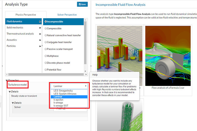

Going back to the Turbulence Model options on SimScale, you will find both laminar and turbulent models in the dropdown menu. For example, for an incompressible flow simulation:
Laminar Models
Laminar
Turbulence Models
LES Smagorinsky
LES Spalart - Allmaras
k-epsilon
k-omega
k-omega SST
For more details about selecting LES or RANS k-epsilon, k-omega, or k-omega SST see: https://www.simscale.com/forum/t/a-discussion-on-turbulence-models/29836
