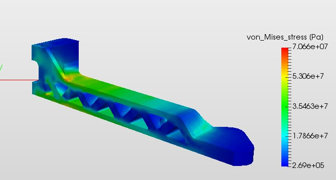

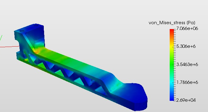

i am using the drone arm sample. The load at the end of the arm is 10N. Simulation and post processing went well.
Now i changed the load to 100N, defined a new simulation run. The run went well.
But: the result in post processing are exactly the same compared to those of run 1.
I definitely used solution fields of run 2. I checked the constraints of run 2. The load is 100N.
