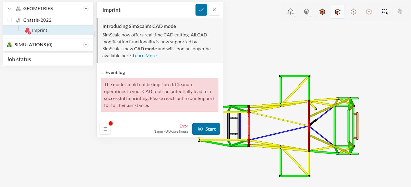

Hey, I am trying to do the torsional test for my chassis. My connections are not getting defined properly at the rear and imprinting is also failing.
Can you please help me set mu CAD out

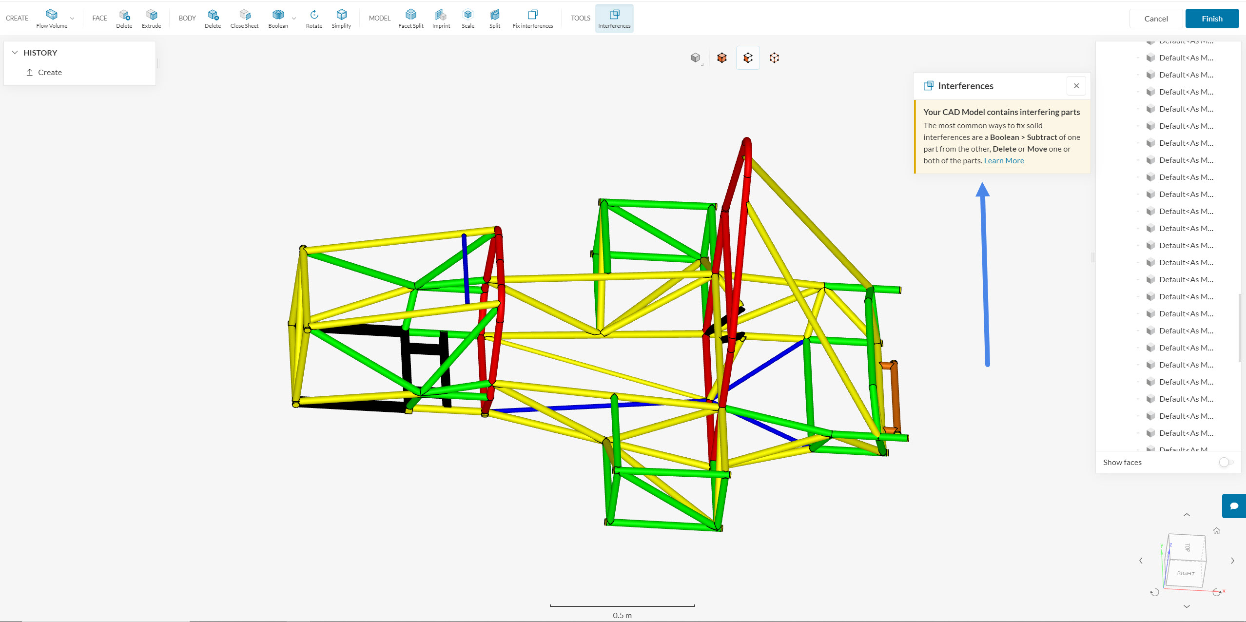

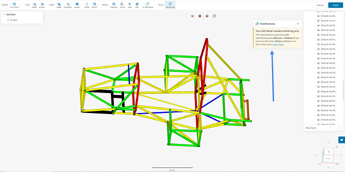

And as @cjquijano said, the model indeed contains interferences:
All the sections that are colored in red below indicate overlapping parts:
You must make sure that no interferences occur before you upload the model and imprint it :slight_smile:

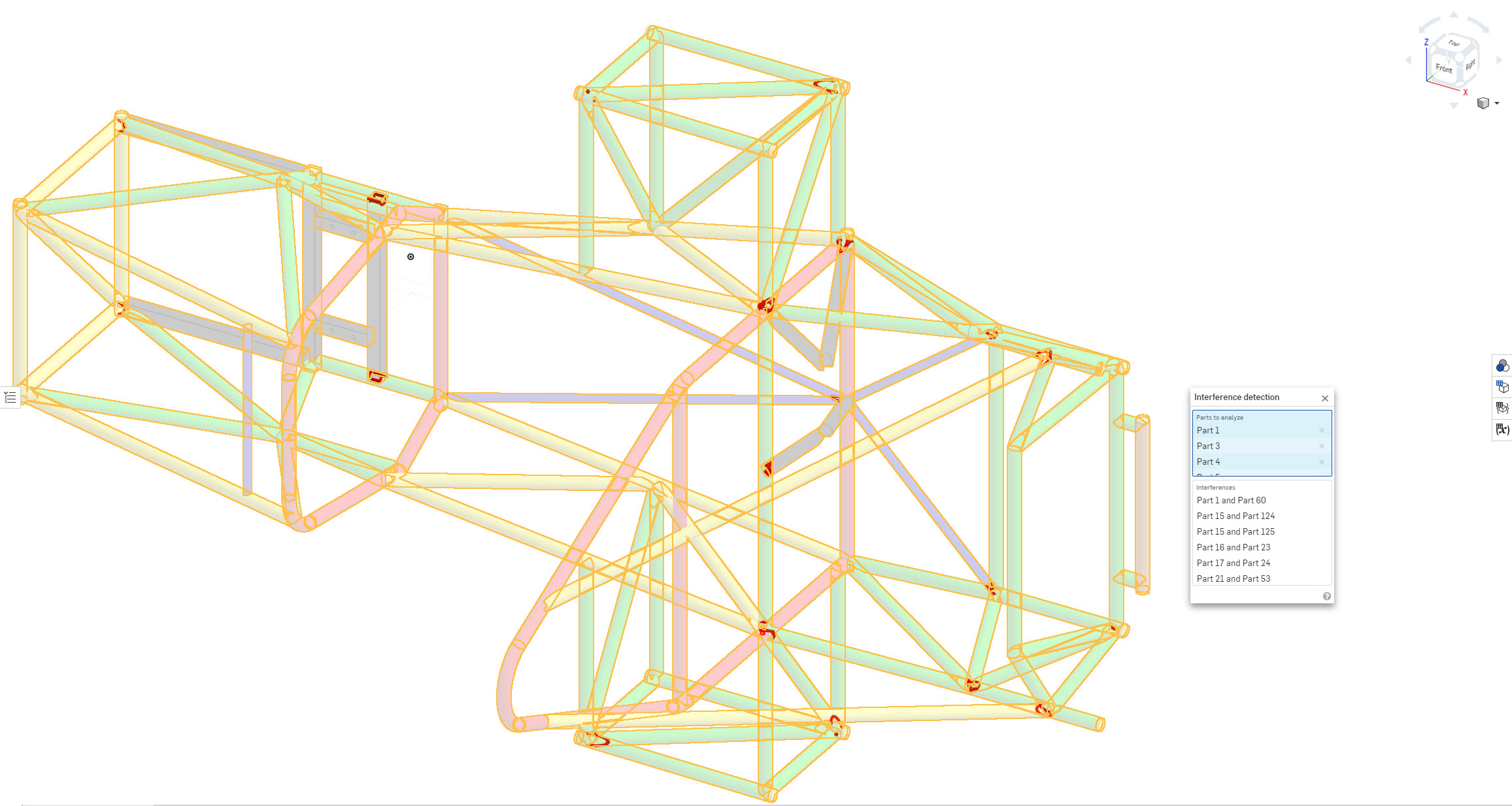

Thanks a lot and can you tell me how to check for interferences so that next time I can Check it on my own.

I am using the cloud-based CAD software OnShgape to check for interferences and then fix them :slight_smile:
