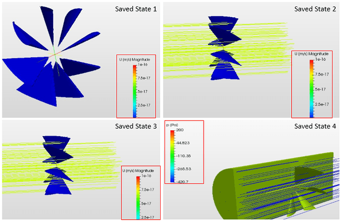

The data show are all messed up. The scale does look alright, but please look at the trace lines and color of the surface. The traces are straight through the shown surfaces. When saved the result was as one would expect, straight flow until subjected to the blades and then twisting motion of the fluid.
Does it make sense that any result is actually missing after saving the state?

That’s because nothing is rotating inside your setup - the propeller is completely standing still. You have to make sure to assign a rotating zone first and also add this in the mesh. A nice tutorial can be found here: SnappyHexMesh - MRF.

@akhm74, as Jousef said, if you are trying to verify the blade influency in the flow, you need to set a rotating zone using MRF or AMI.

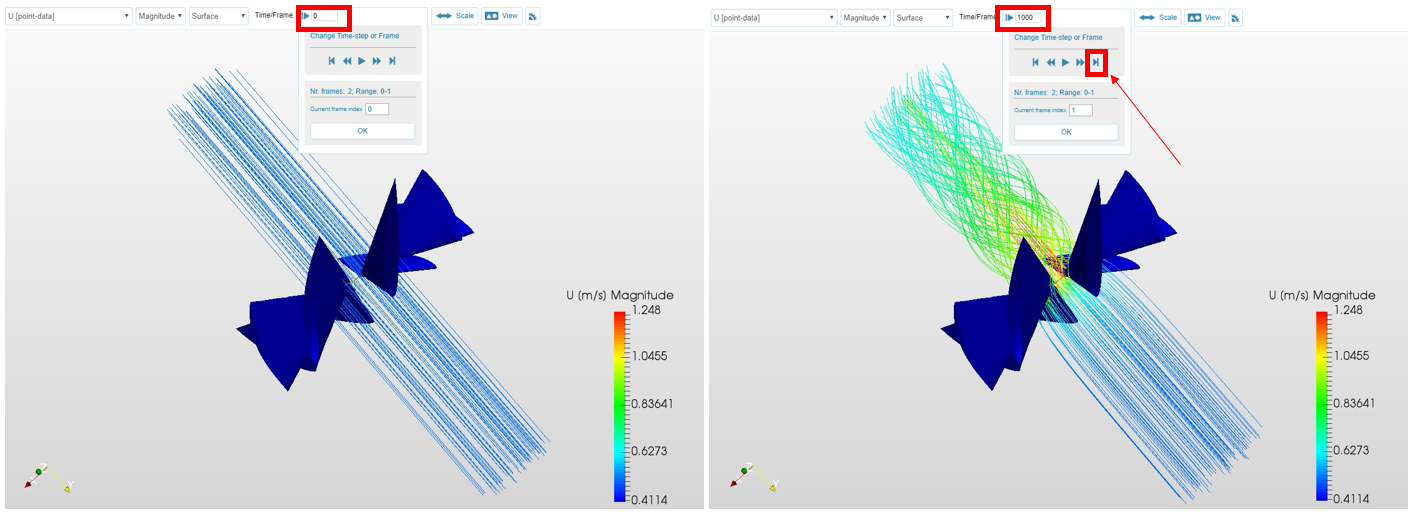

However, I took a look on your saved states and all of there was in the first state (0) where nothing occurs. So if you want to see the air through the steady-state blade (which is uncommon), you just need to put in the last state of your simulation (1), look:
I hope it help you. Please, let us know if our suggestions worked for you!
Vinícius
