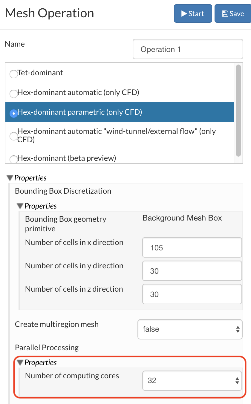

i am Working on My Project for Wind turbine and when i am generating the mesh with different parameters and play. after sometime of computing it says run out of memory and need a bigger machine what is that means can you please help me .
Thank you
Hi @bhavdeeppatel91!
Try increasing the number of cores as depicted in the picture below. If you run into trouble please let me know!
Thank you For your Rapid Response.
i have changed the Cores and now its been processing.

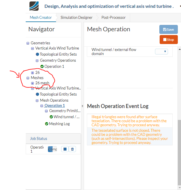

Moreover i have added 2 geometries in one project and i want to cancel one of them and when i am doing by right click on it to delete it says contact simscale. can you please guide me as well.
Thank you
Can you post a picture of your problem? Usually you stop the mesh process first and can then delete it. If you post a picture it makes is easier to identify the issue.
Hi Jousefm,
i want to delete 26 geometry as shown in picture.
Hi ,
i have completed the mesh step now moving forward. and also deleted the geometry the stopping of mesh works on to delete the another geometry. thank you very much again.
If the operation is running for “26 mesh” stop it first and after it stops right-click on the mesh and delete it afterwards, that should work.
