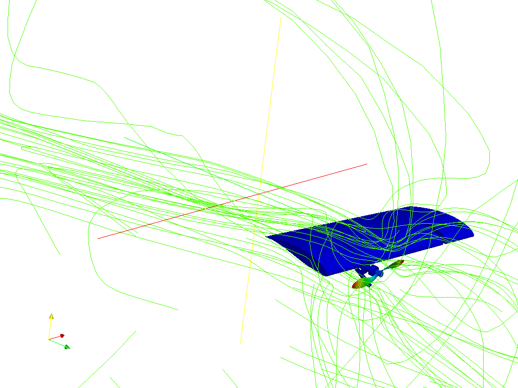

I’m having a problem with stream lines in my simulation. I’m trying to simulate the propeller spinning and for some reason my stream lines are all over the place. At first I thought that the propeller was maybe spinning backwards, but I have since proved that not to be the case. I’ve tried all sorts of things like changing the bounding box size and nothing seems to work. Any thoughts? Thanks!

Hi @ejohnathon!
I have modified your project by defining an inlet velocity which was zero for every direction. Works fine now!
Project ejohnathon
Cheers and happy SimScaling!
