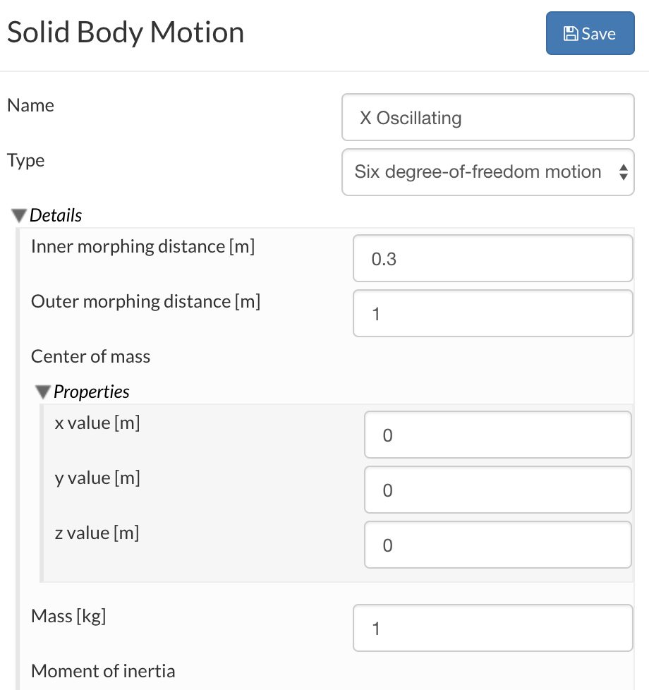

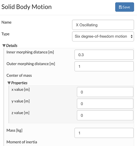

Nice project idea here, awesome! :slight_smile: First idea from my side is to use a 6DOF Motion that can be found under Advanced Concepts inside the Multiphase module. To stop the rotation I think using a constraint could work but I did not try it myself to be honest. Darren (@1318980) has already done a sloshing simulation and might give you more hints on that one although the sloshing simulation was just an oscillating motion.

Well, I’ll try to use a 6DOF Motion as you suggested. For community: any kind of tips here is still very welcome since I really testing some of conditions in this simulation.
