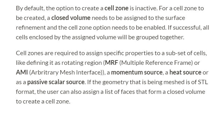

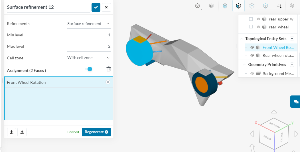

I think i have cracked the solution of the problem you were facing. You were not able to assign the MRF rotating zone to the volume in your simulation, is it right? To able to select the volume for MRF rotating zone, you have to create a surface refinement of the parts with cell zone option ON.
