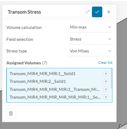

When selecting a volume calculation to show the min-max stress, if you select multiple volumes, does it accumulate them?
I.e
max stress in volume 1 + max stress volume 2 = max stress
or
Max stress in a single component?
I.e
or
Hi!
If you select multiple volumes, the maximum will be reported over the whole selection.
So the accumulation of the max stress in each volume?
Please clarify to me what you mean by ‘accumulation’, I would like it if we can speak the same language.
As an example:
IF volume 1 max stress = 1 Pa
& volume 2 max stress = 1 Pa
Will the output graph max stress = 2 Pa or 1Pa?
Hi, in this case, it will be 1 Pa.
You can also try it, for example by creating separate result controls for each part and one for all of them. If you find a different behavior, please let me know!
