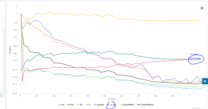

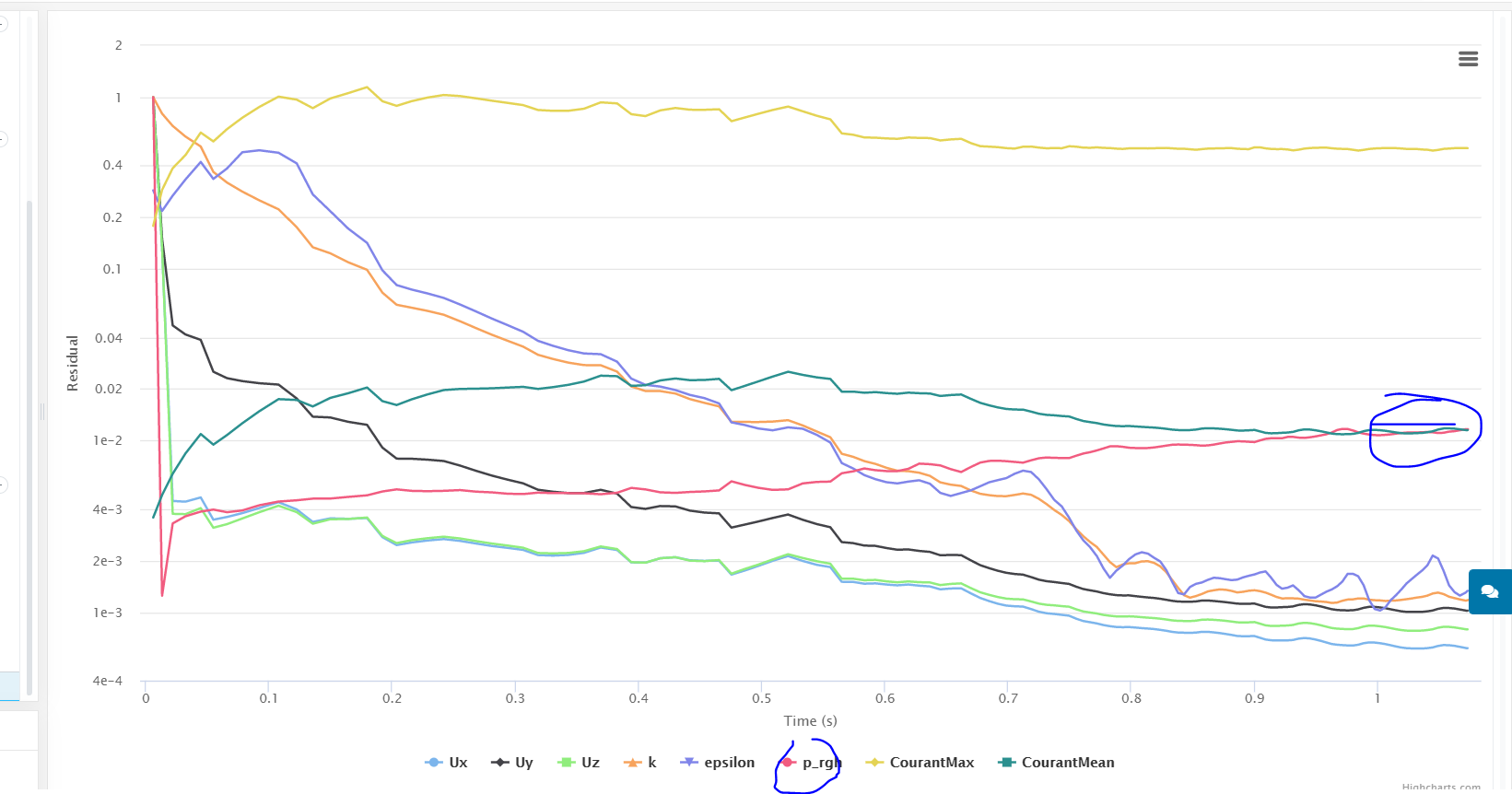

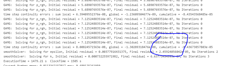

I have a problem understanding the residuals plots. When I look at the run log they seem to be very low .
However, the plots seem to report a higher value?:
Question 1: Are the plots reporting residuals at the first iteration within the time-loop and not the final one (after convergence)?
Question2: Could this be changed? Maybe I want to plot for each iteration with the time-loop…
