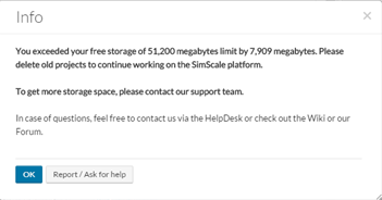

Good morning @anon67859130, I’ve had a similar problem making the sesion 1. For me only was possible to make 4 simulations, corresponding with the first model and the four rotational speeds, but when I tried to make the first simulation with the second model I got a message indicating that I have exceeded the free storage, as is related in the next image.

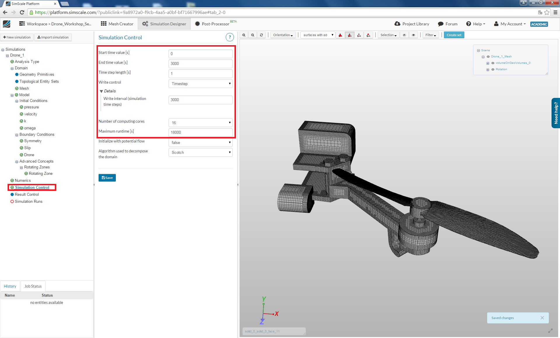

Hello Jhon,
for me it seems that you chose the wrong settings in the simulation control panel.
The default value for Write Interval ist 1, which means that every intermediate result will be saved. For this simulation with 3000 iteration that will result in a 3000 times larger simulation project.

Hello @Milad_Mafi, I appreciate your attention. I reviewed your annotation, but It seems not to be my problem, even I changed the Write Interval value, I remain receiving the same message, inclusive I deleted all the tutorials files made. Additionaly, the value of 3000 in the “Write Interval” was used, taking into account the "step by step tutorial: homework of session 1 - level 1, paragraph related to the picture IMG16.png.
In the error message window that appeared, I informed the same problem to the SimScale platform, specifying that actually I have an “ACADEMIC” plan, due to a message received on october 13th indicating the finish of my free trial.
I’ll keep on setting up the parameters of the four remaining simulations, and the corresponding with the session 1 - level 2, until It is possible getting a solution.

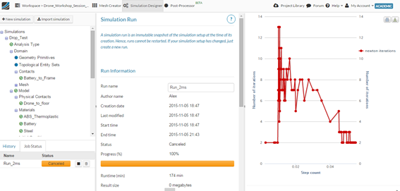

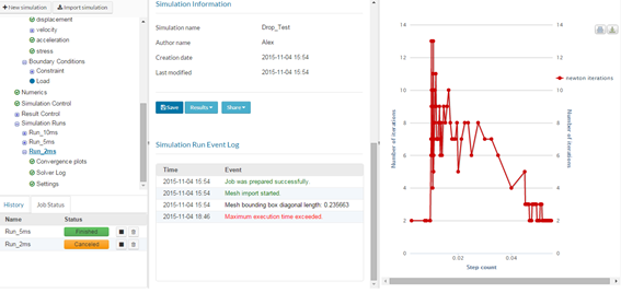

Hello Milad, I´ve got a problem in the homework Session3 - Level1. The simulation run for 2ms was canceled with the following message: “Maximum execution time exceeded”. The length of computing was more than 4 hours and afterwards it was canceled. Just to let you know, the web connection here in my country is too slow. Appreciate some help.

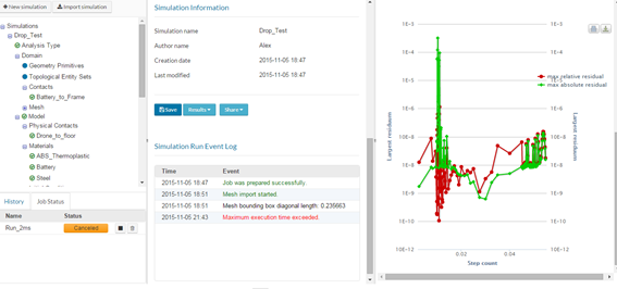

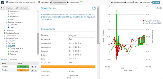

Please, find below the screenshot. Thanks.

Hi @Alexor,
generally the simulation runtime should not depend at all on you personal web connection speed.
From your convergence plots it seems that your initial velocity is much higher than 2m/s, since the impact starts at about 0.01s. Could you verify your initial velocity settings?
If the initial velocity is correct, could you then share your project via public link so that we could have a look at your simulation and find the problem?

Thank you Richard for your prompt response. I verified the screenshot I sent out and the convergence plots is from the 5ms run simulation. I don´t know what happened.

Hi @Alexor,
this is already answere here. The settings of the initial velocity were not correct.
