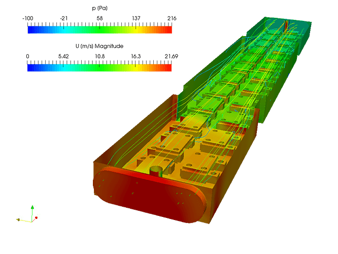

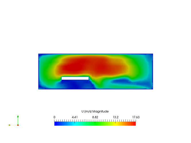

Now i tried a new configuration with changed numerics and the simulation runs worked just fine.

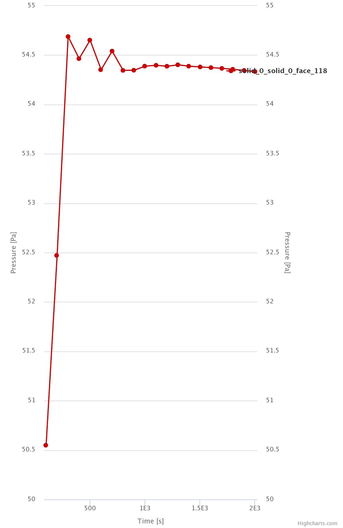

I also got the pressure drop thru the cooling “duct” in relation to the volume flow:
Cheers and all the best!
David
Awesome @dnaumann! Happy that it worked!
Do the results match your expectations?
All the best!
yes the results matched my expectations, i needed the pressure drop to select a matching fan.
David

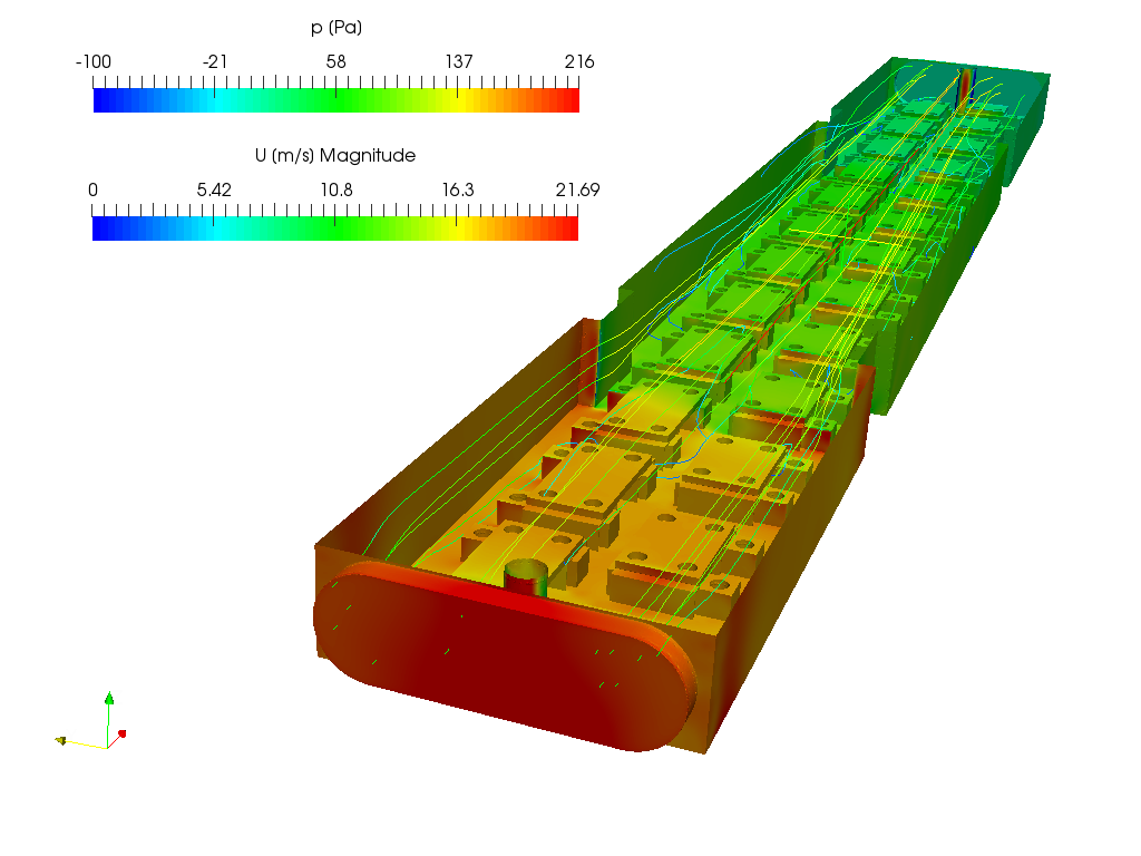

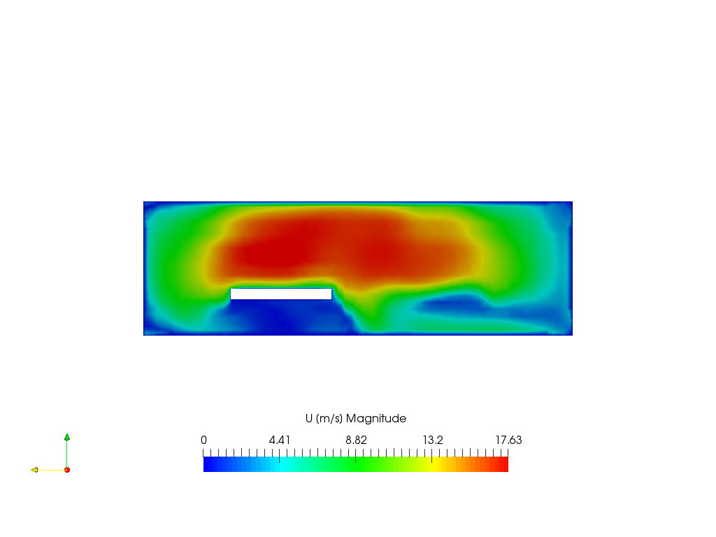

@dnaumann - post-processing looks good!
