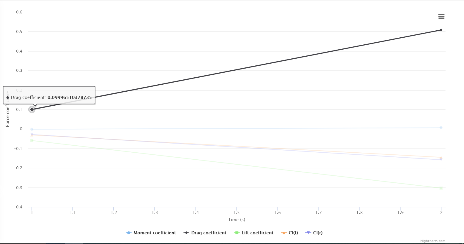

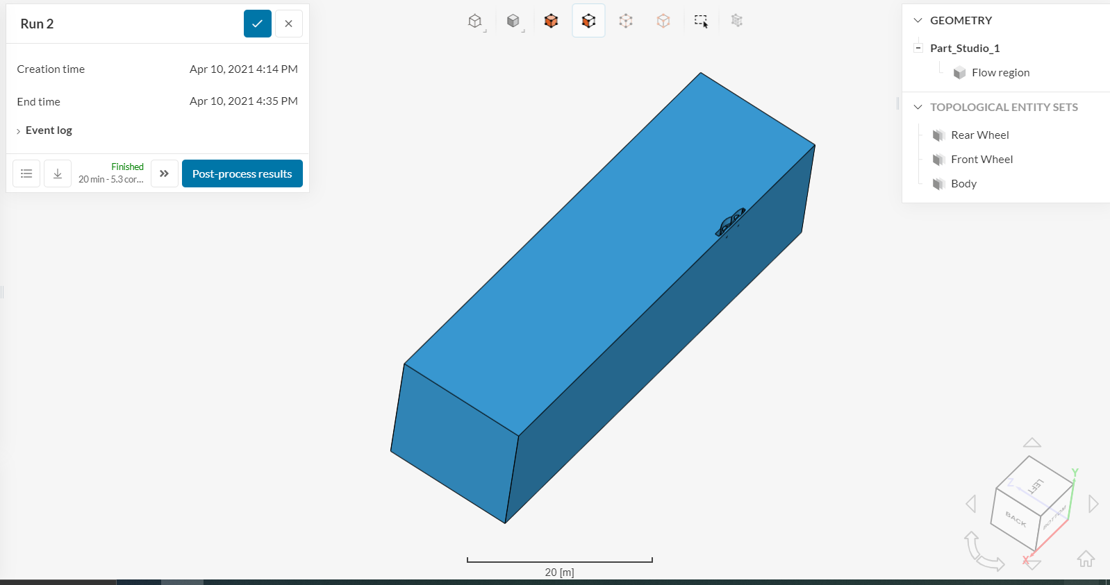

This shows that my simulation is finished but it took only 20 minutes. It should last at least 290 minutes.
This is why my chart shows only 2 seconds instead of the needed 3000 seconds. My question is what causes this failure of a simulation and how do i fix it.

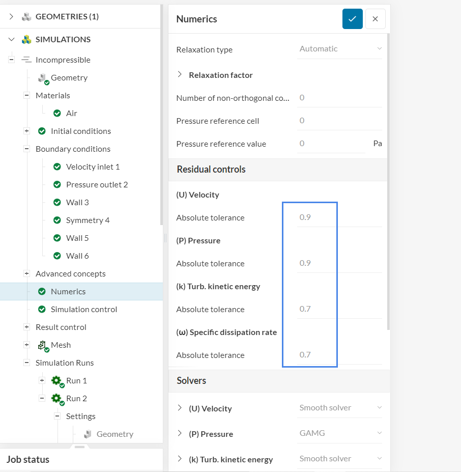

The problem here is the residual control definition under Numerics. These values must have been changed by you, since the default settings are very different:
The absolute tolerance for the residual controls acts as a stopping criteria for the simulation. When the residuals from all these parameters drop below the defined values, the simulation is stopped. The default values are 1e-6, if I recall correctly.

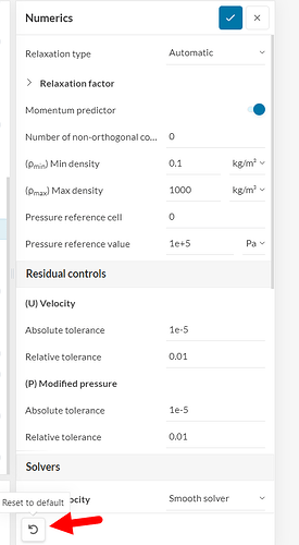

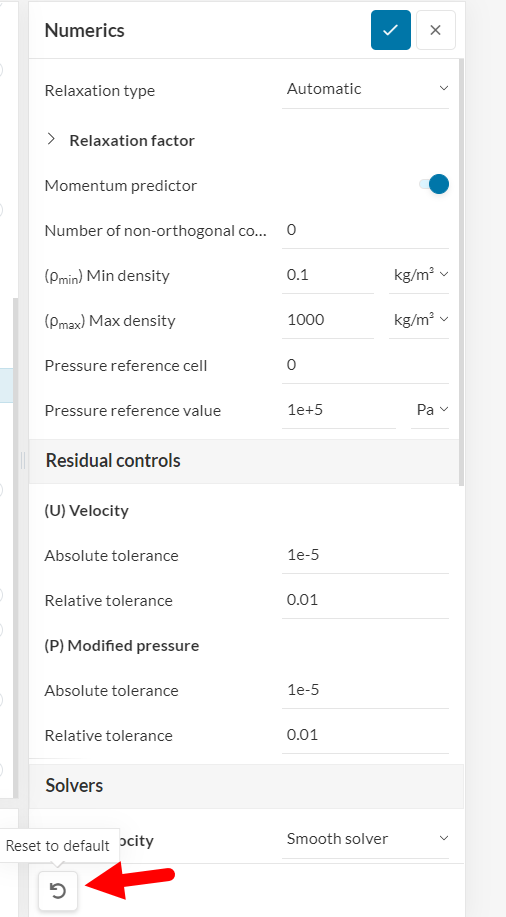

With values of 0.9, the simulation achieves the stopping criteria after 2 iterations and stops. In short, I would recommend refreshing the numerics to default (there is a reset button right here):
