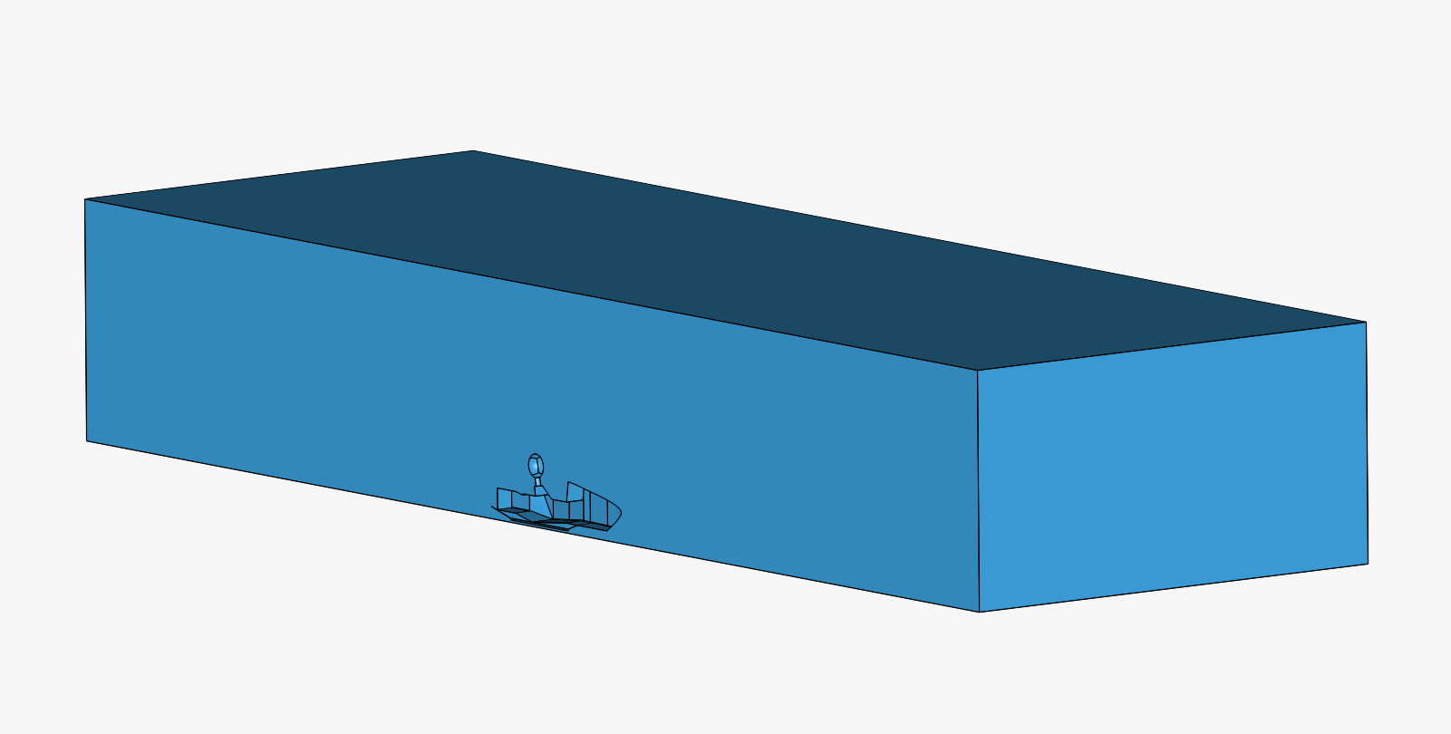

  1. Your bounding box is much too small for an FSAE car. Try a total of about 30 meters (10 in front 20 behind) Usually the bounding box should be 10x your geometry.

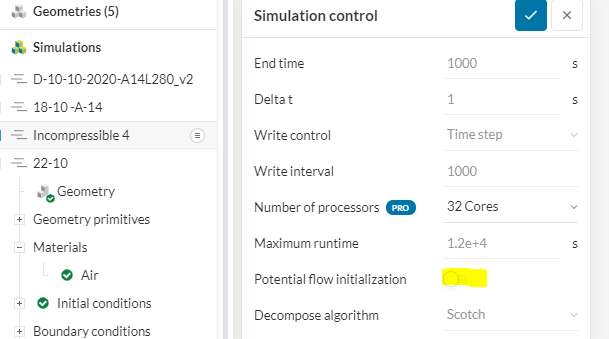

  2. In your simulation control always turn on Potential Flow Initialization, it helps converge the solution quicker

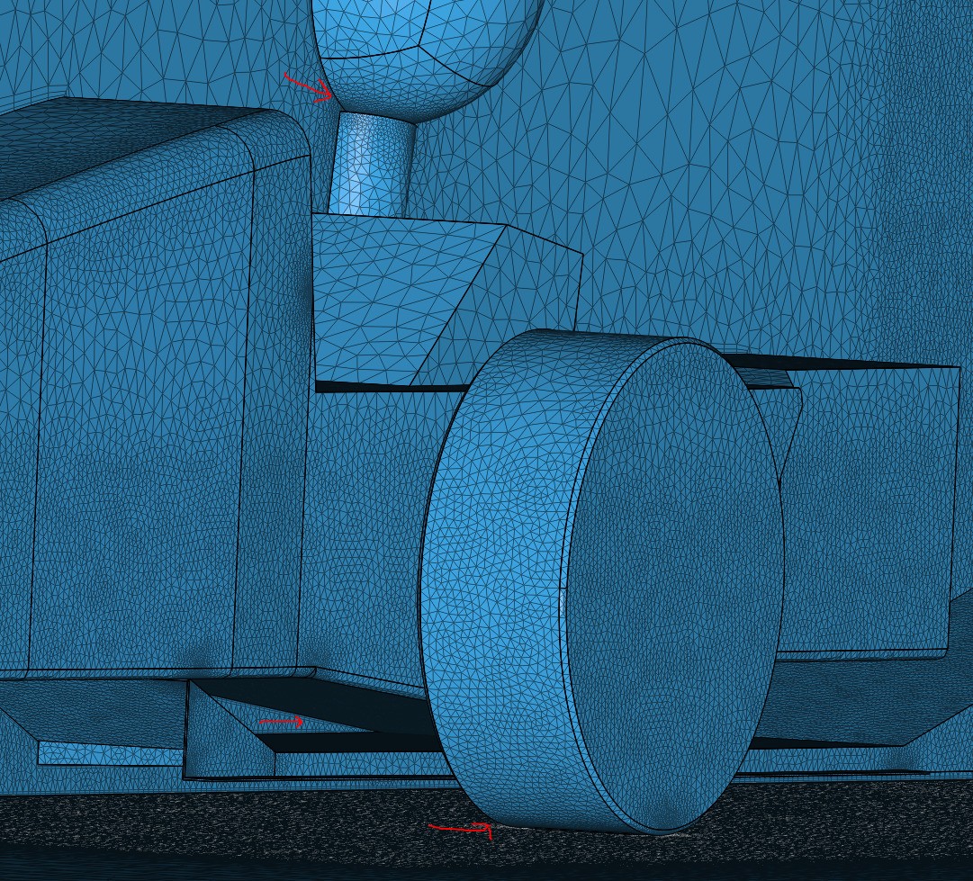

  • meshes dont like sharp corners. the red arrows show where you should add fillets or chamfers to help avoid BL deletion. Also it would be better to increase the size of your contact patch for your tire

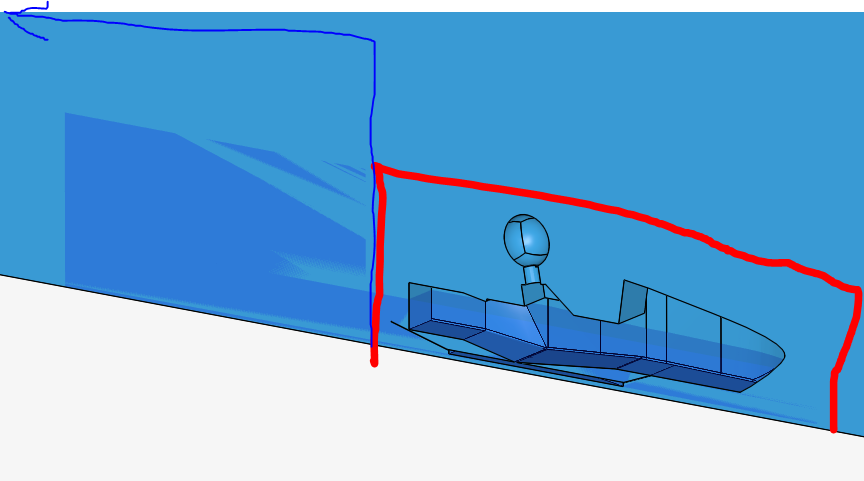

  1. Increase the size of your region refinement to include the whole car (red) and a slightly coarser cell region refinement behind the car for the wake.

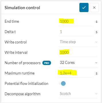

In your simulation, you have set the End time and Write interval to 1000. For a half car simulation, i would set this to 2000 minimum. A good test to do for your very first sim is to set these values even higher (5000) and watch the convergence plot. You will be able to see when the values stabalize and will then know where you should stop your simulations.
For example… if you see that after 1800 iterations the residuals become satable, then let it run for about 500 more iterations after that point and then use that as your new write interval for further simulations (2300)

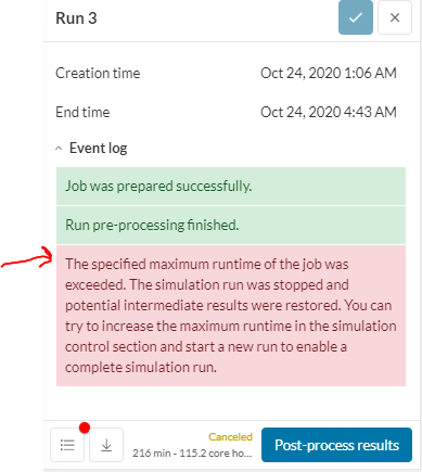

This Message comes up when your Maximum runtime (from simulation control tab - see above) is exceeded. I would set this to a much higher number so that you wont get this message anymore (1.2e+5 or 4e+5)
