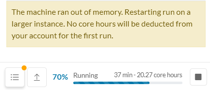

My simulation has been stuck on 70% for a while now but I don’t want to end the simulation as I have been waiting a long time for it, what should I do?

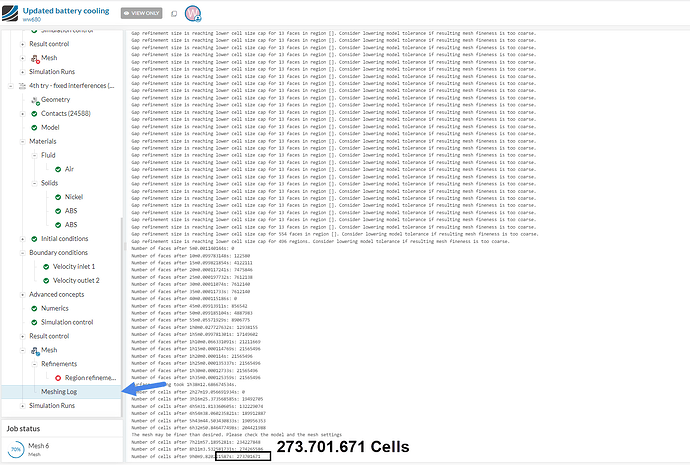

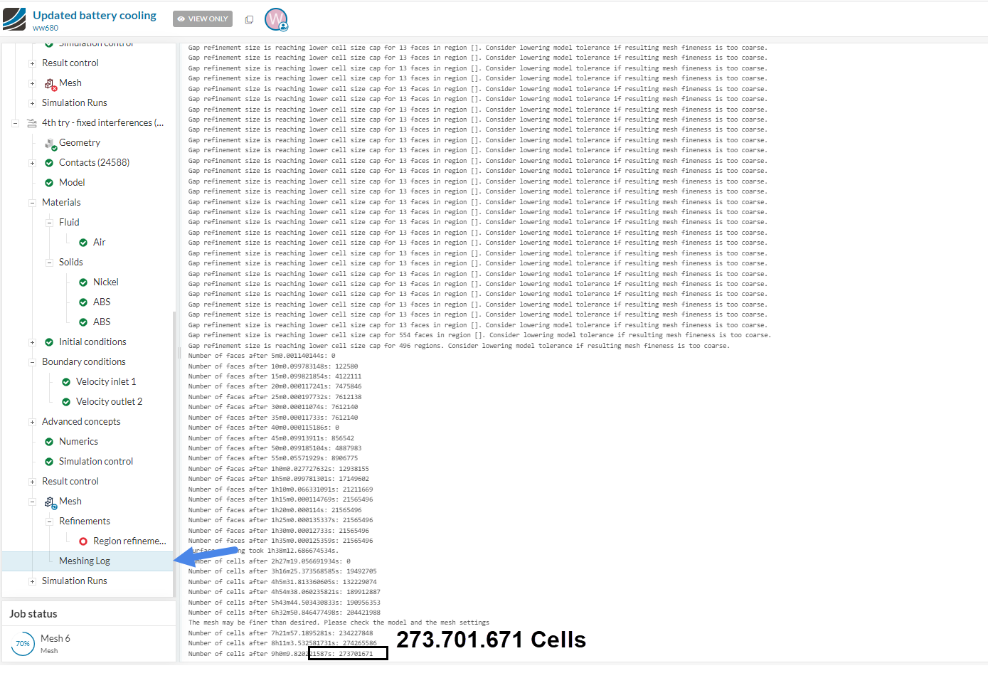

due to the huge number of small faces, as described in my post before the mesh is taking very long.
As you can see here in the meshing log. The process is still meshing with 273Million Cells being produced.
I would recommend to stop this mesh operation, as the simulation will not be able to run, with such a huge mesh.

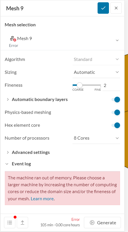

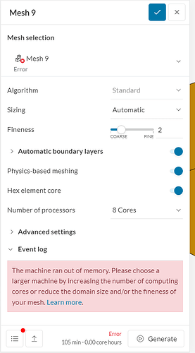

I have reduced the fineness of the mesh to 2 (more coarse) and I have increased the number of processors to 8 on both mesh and simulation control, however the time taken to run the simulation has not been affected. HELP
This error has occurred 105 minutes into the simulation run which I’ve already made adjustments to? This never popped up prior to increase number of cores and decreasing fineness of the mesh so it doesn’t make sense as to why it would show up after I made these changes?

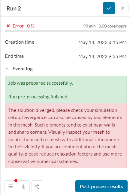

I have decided to use a singular module and the mesh is able to generate, however when I try to run the simulation this error pops up and I don’t know how to fix it:
Making the mesh more fine did not fix this issue
