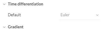

I’m working on a project with external flow at high Reynolds and LES turbulence model. In my current setup I’m unable to change the Time differentiation scheme from Euler to a Second order type like backward.

Hello Andrés, hope you are doing well.
Euler implicit is the only time scheme available for transient simulations at the moment. That’s why once you select a LES turbulence model, which automatically enables transient option by it’s nature, time differentiation is selected as Euler, and grayed out.
