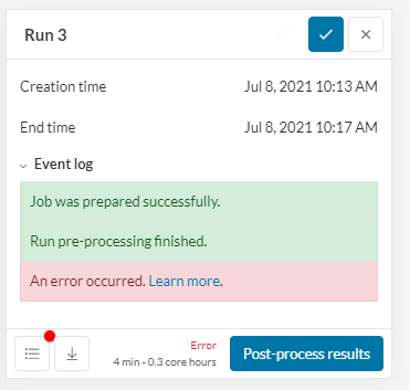

Hi, i am working on an project similar to an oven.
I am trying to mimic the thermal management inside but i have a fatal error.
Can you help me figuring out what is going on?
Thanks

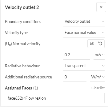

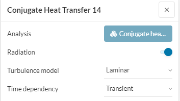

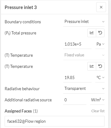

Yes i still can’t lauch transient simulation with radition on the “oven”
Hi there,
Transient simulation with radiation should be a computationally costly one. Based on your result expectations, can you use the steady state results?
On the other hand if you are not interested in the flow characteristics, you can model the fluid as a solid and use the FEA Heat transfer with transient to achieve the required results.
Please try these and let us know if that helps!!
