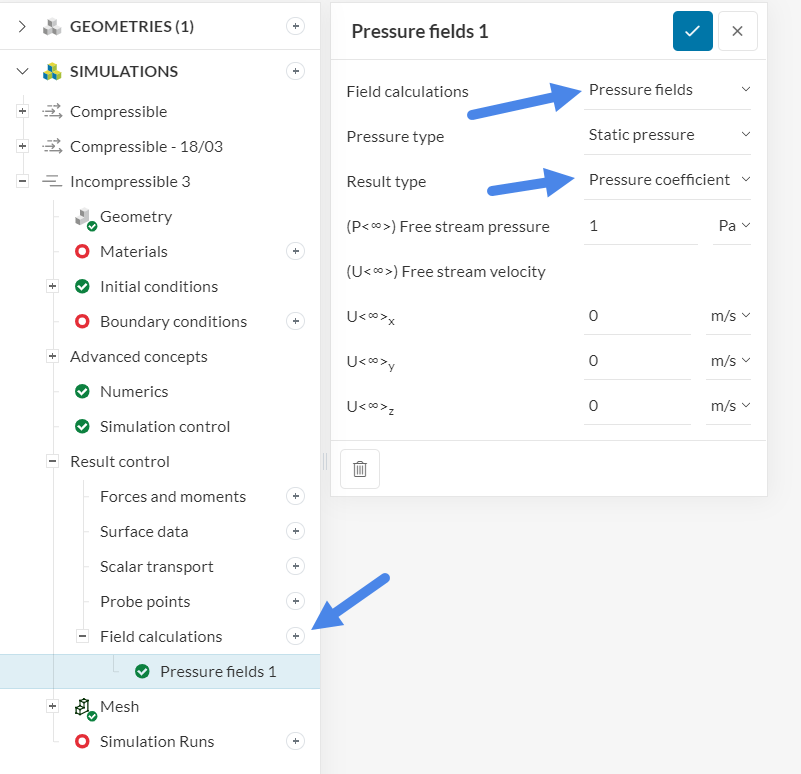

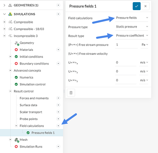

Does Simscale calculate pressure coefficient at different locations?
Regards,
Syed
Hi!
It does, but you have to define a result control for it before running a simulation, otherwise it won’t be available in the post-processor.
