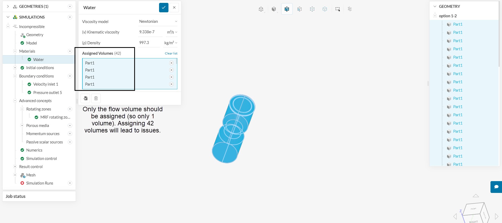

Hi, I am seeing the following error
In single region simulations, only the fluid region can be assigned to a material. Please review your material assignments, making sure that only the flow volume region is assigned
How to close this error?

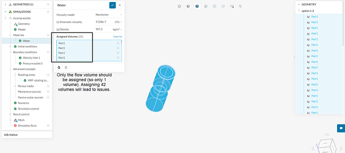

In single region simulations, only the fluid region can be assigned to a material. Please review your material assignments, making sure that only the flow volume region is assigned.
plz help to resolve by looking into the model once again
The error message is quite straightforward: for the material assignment, only the flow volume should be selected. The other volumes (which are going to be cell zones) should not have any material assigned to them.
