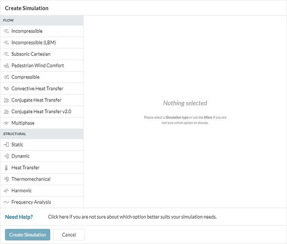

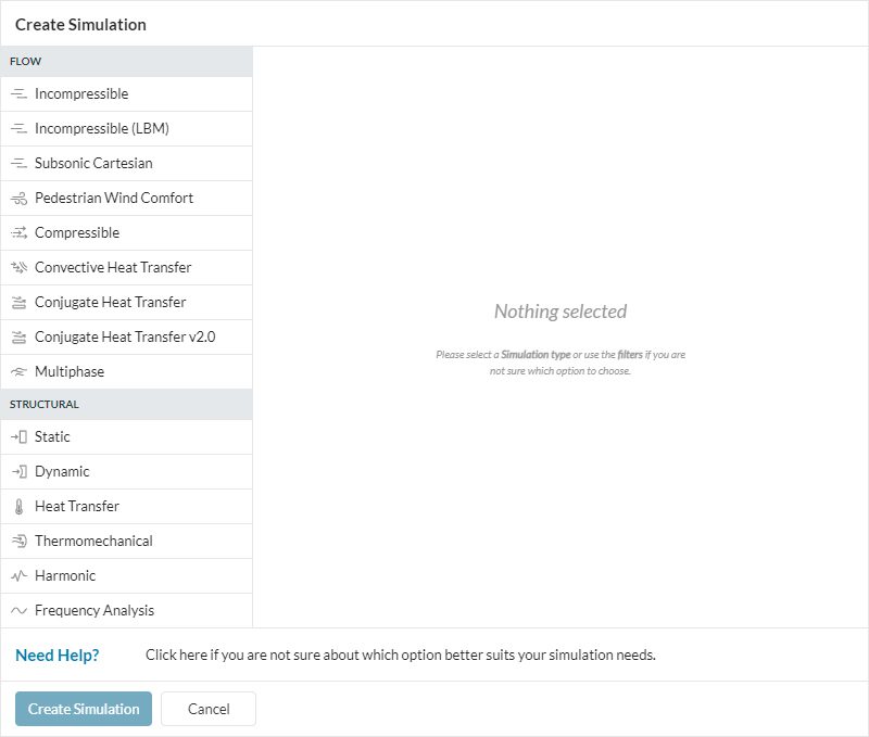

Hi Andrew (@alindsay) ,
Welcome to SimScale! As far as I understand, since the pig is being pushed ahead in the pipe by the pumping in of the air this would be a 2 way fluid-solid interaction problem which is not (yet) supported on the SimScale platform. Interesting application though - you can read more about the CFD analysis types that we support here:
