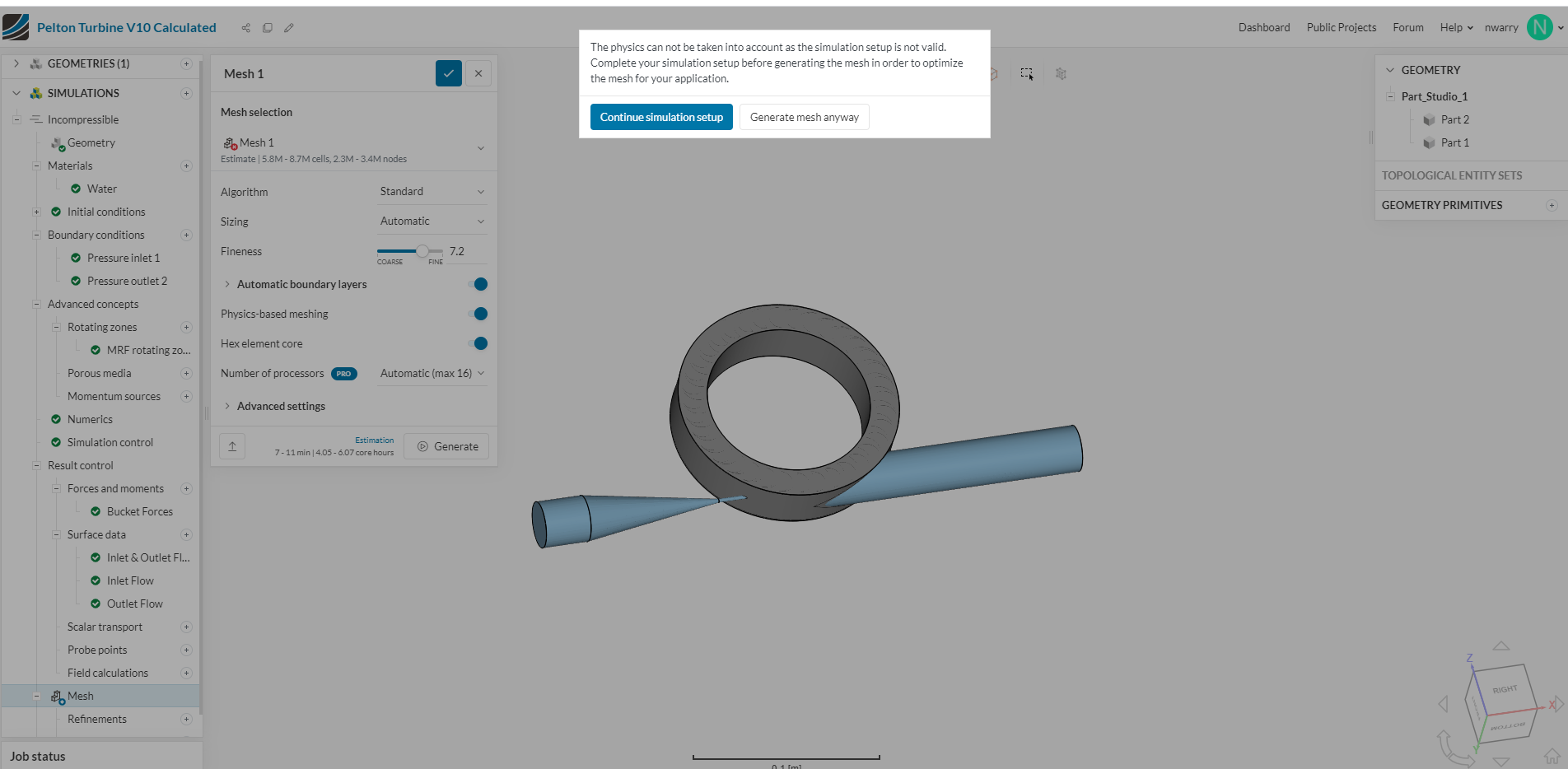

Followed all tutorials and have set up countless similar projects, however can not seem to fault find the issue with this latest one.
It says that meshing is not possible due to:
“The physics can not be taken into account as the simulation setup is not valid. Complete your simulation setup before generating the mesh in order to optimize the mesh for your application.”
Have altered the design as much as possible, but considering I have similar simulations I’m concerned this could be a software bug?

Thanks for having a look. I feel like I’ve tried everything with this one so when you had a look I had at this stage reset the design to see if I could get around the issues, but alas no.
Still wondering if there could be a bug as I dont know what is missing with this one that makes it a physics nightmare compared to the other designs I have done.
As mentioned I’ve followed the tutorials, but am still stumped. So for now I have populated the required fields as it was and included a screenshot.
The error is caused by the ‘Inlet & Outlet Flow’ surface result control item. The character ‘&’ is not allowed in the name. Please change the name and you should be good to go.
