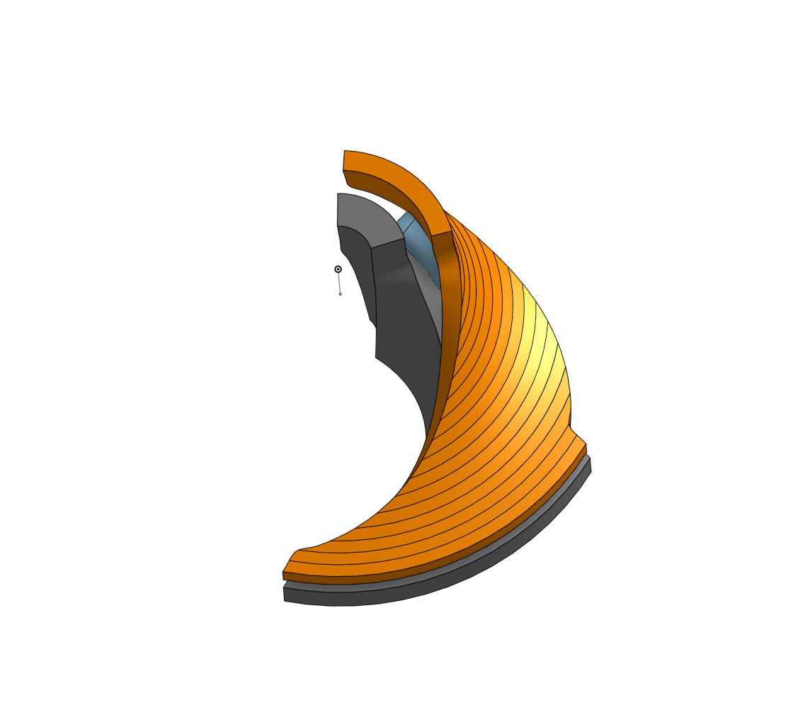

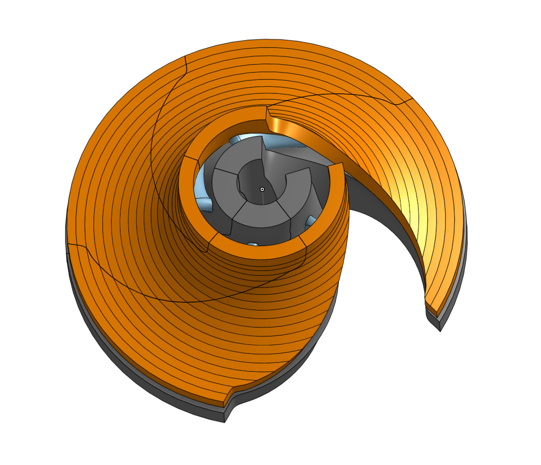

I am trying to simulate the flow around a single blade in a small shrouded centrifugal pump. I attached a picture of the geometry and the link to the onshape CAD file and the Simscale project below. I am trying to do the simulation on a single blade (picture on the right).
However, I am unsure about how to define the boundary conditions.
Reading the documentation for the periodic boundary condition it mentions that it does not support the rotational periodic BC Is there a way to work around this? Would it be simpler to just include the full geometry?
Also, I am unsure about the difference between using rotating wall boundary conditions for the walls of the impeller blade and using an MRF (similar to this example: Fluid Flow Through Centrifugal Pump | Tutorial | Simscale), specifically if I only have one blade to worry about. Physically it seems like they both should do the same thing. Is there an advantage in using one over the other?
