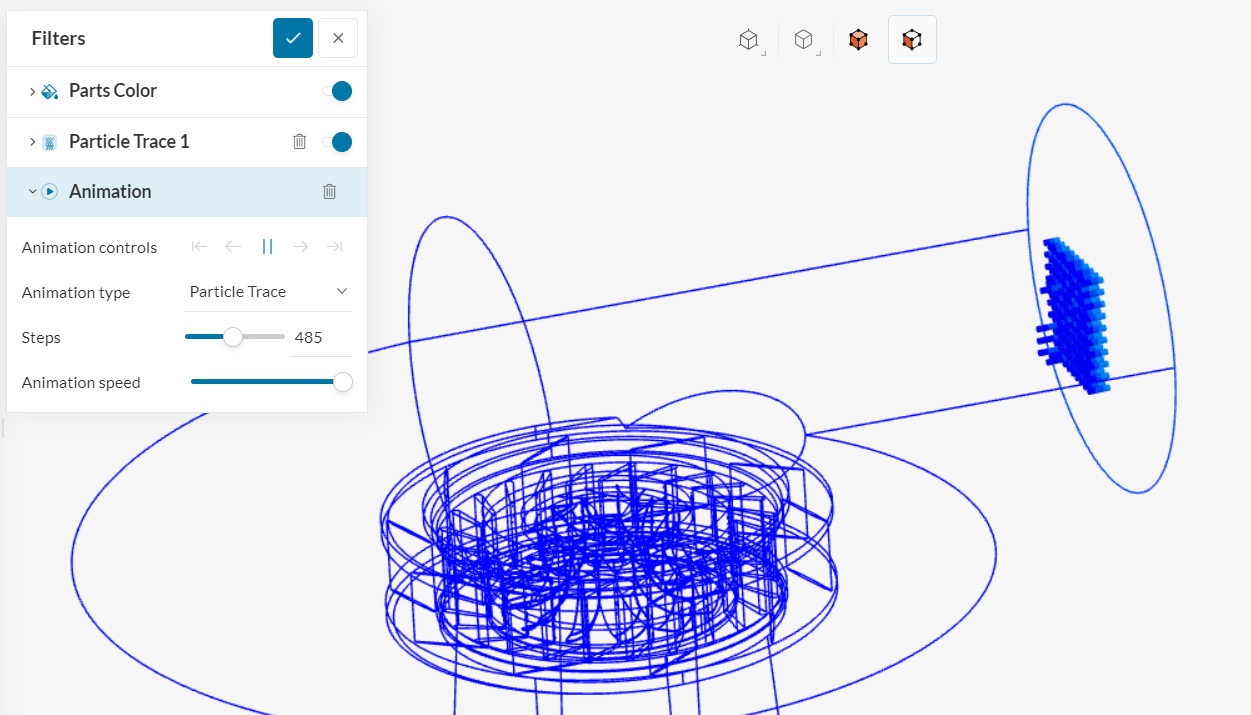

I tried the particle trace function to observe the flow but the result is really weird. The trace is confined is this rectangle space at the face I set.
What is the problem ? My simulation or I do not use the particle trace correctly ?

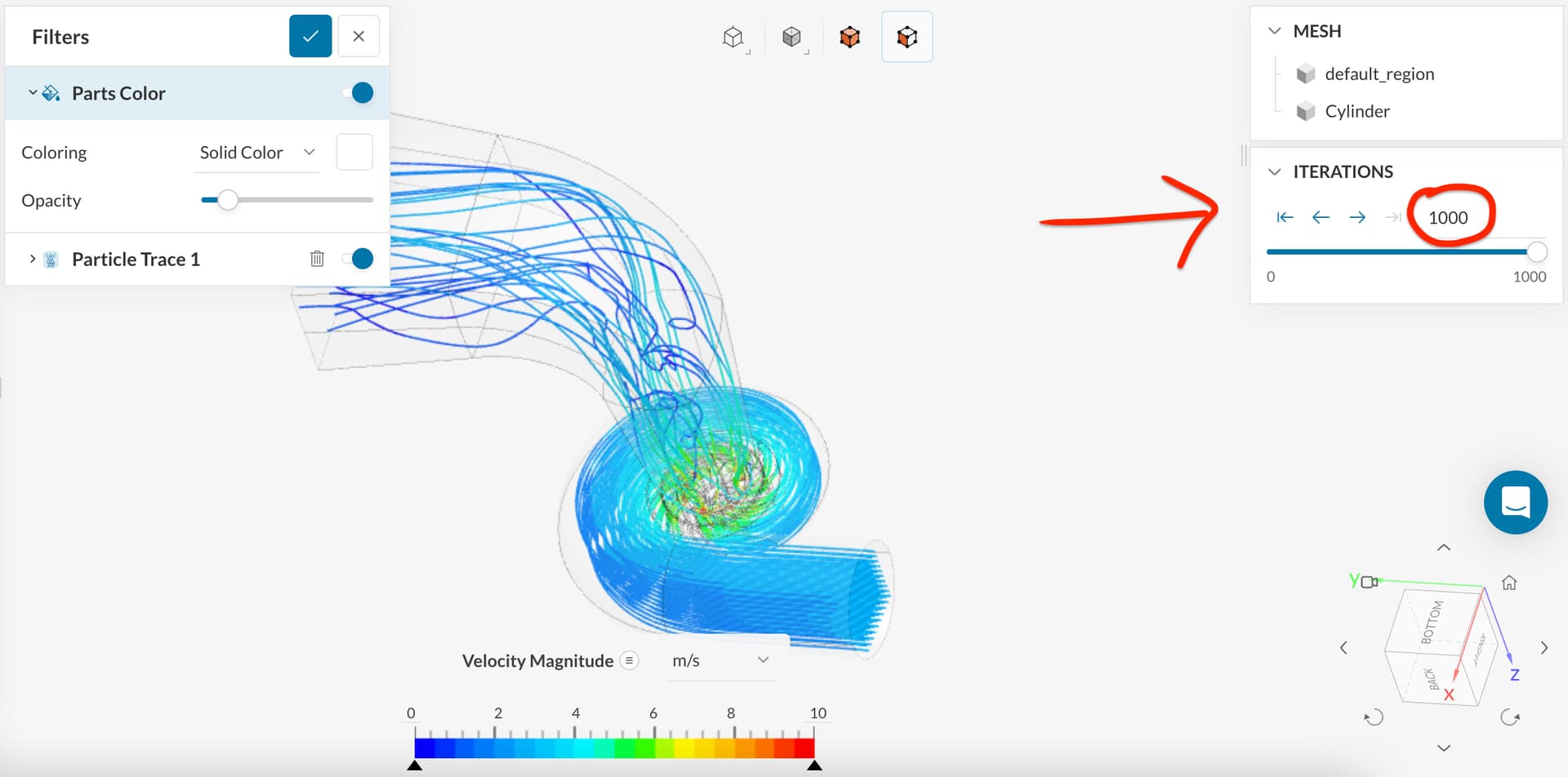

Hi @mshaipul_anuar,
I took a close look at your project and it seems good, so no problems with that. Please do a check if you have selected the final iteration on your post-processing to be able to see the streamlines.
Please let me know if now it works.

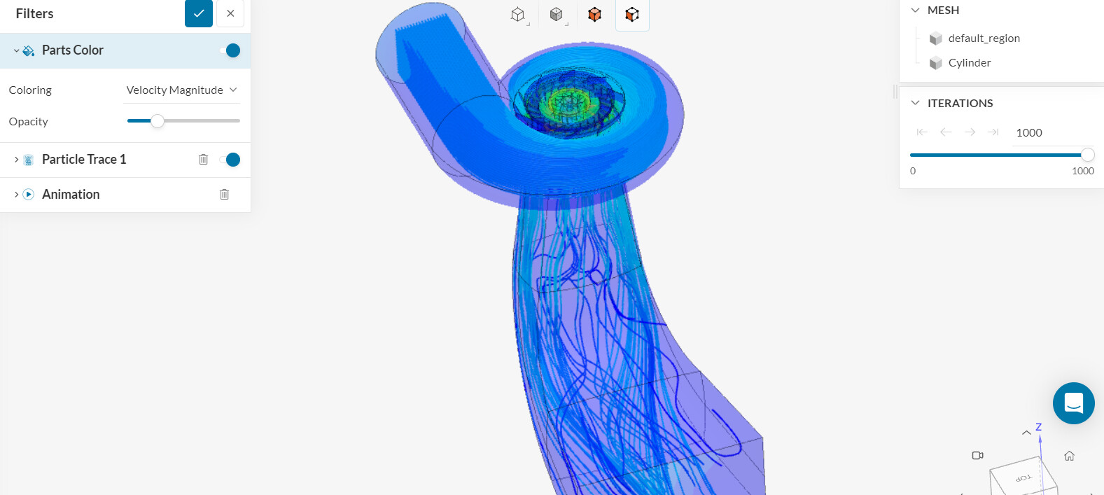

Thanks for your help. It works as you said.
Many thanks,
