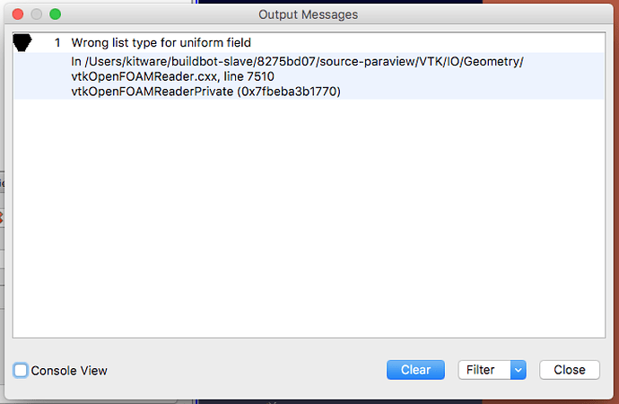

Besides, when I start paraview, it shows me this message: “ERROR: In C:\bbd\7cc78367\source-paraview\VTK\IO\Geometry\vtkOpenFOAMReader.cxx, line 7541
vtkOpenFOAMReaderPrivate (0000024AF0B42280): Wrong list type for uniform field”

But my main reason for writing this is that error message, I thought it was something I had to live with!! Whenever I do anything it pops up:
Really annoying, and to be honest… could the first issue be the cause of the message? (edit, you already said that :smiley: )

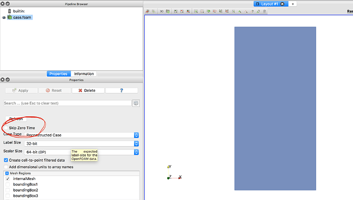

I’m facing the same problem as @sl_pez. I recently downloaded ParaView 5.4.1 and OpenFOAM 4.0 and 5.0. Whenever I open a project, I just can’t see the time “0”. ParaView ignores it and starts from the next time.
I have just seen a screenshot of ParaView posted by @1318980 in the topic named “Using Paraview on a Mac”, as an answer for shinisomara’s question. I don’t know which project was that one, but you can see in the “Current Time Controls” that it starts from time 1000.
Does anyone have an idea of how to solve that?
Kind regards,
@idetoni are you getting an error? if not I think it’s just a that para view by default skips the zero time step here is where to change it:
Kind regards,
Darren
Dear @1318980 ,
Perfect! I hadn’t realised the Skip Zero Time box. Everything workind fine now.
I hadn’t had any error message.
Thank you very much!
