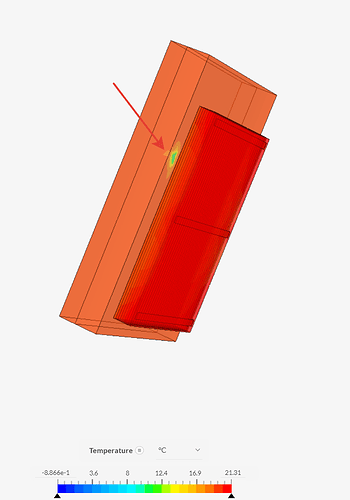

I tried my own simulation (https://www.simscale.com/workbench/?pid=2461777810273282587) and have some weird results:
  1. Why I’m having a cold spot at the edge of the radiator? My amient temperatude was set to 19.85C.
  2. The hottest temperature is 21.31 C only, while the radiator has 3x30 W of power sources (90 W total). I’d estimated that the overheat would be at least 15-20 degrees.
What is wrong with my simulation?
