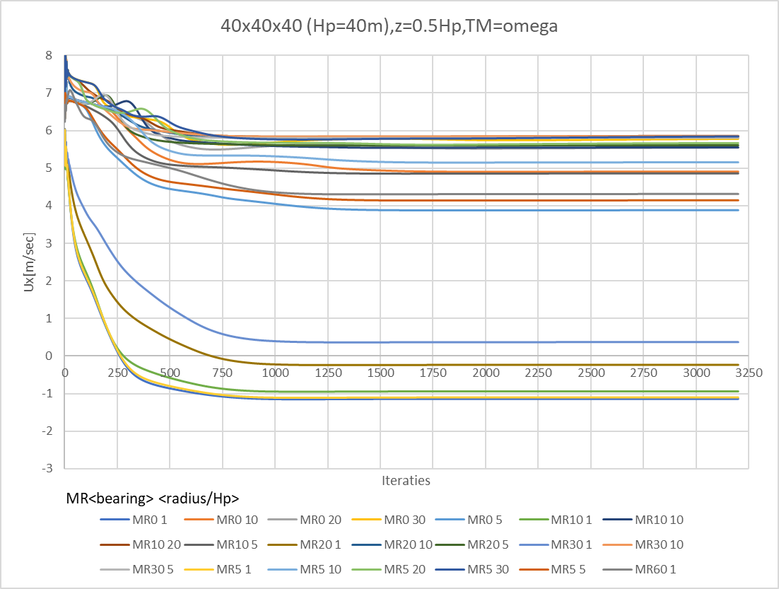

If using k-omega I see nice converging probe point plots:

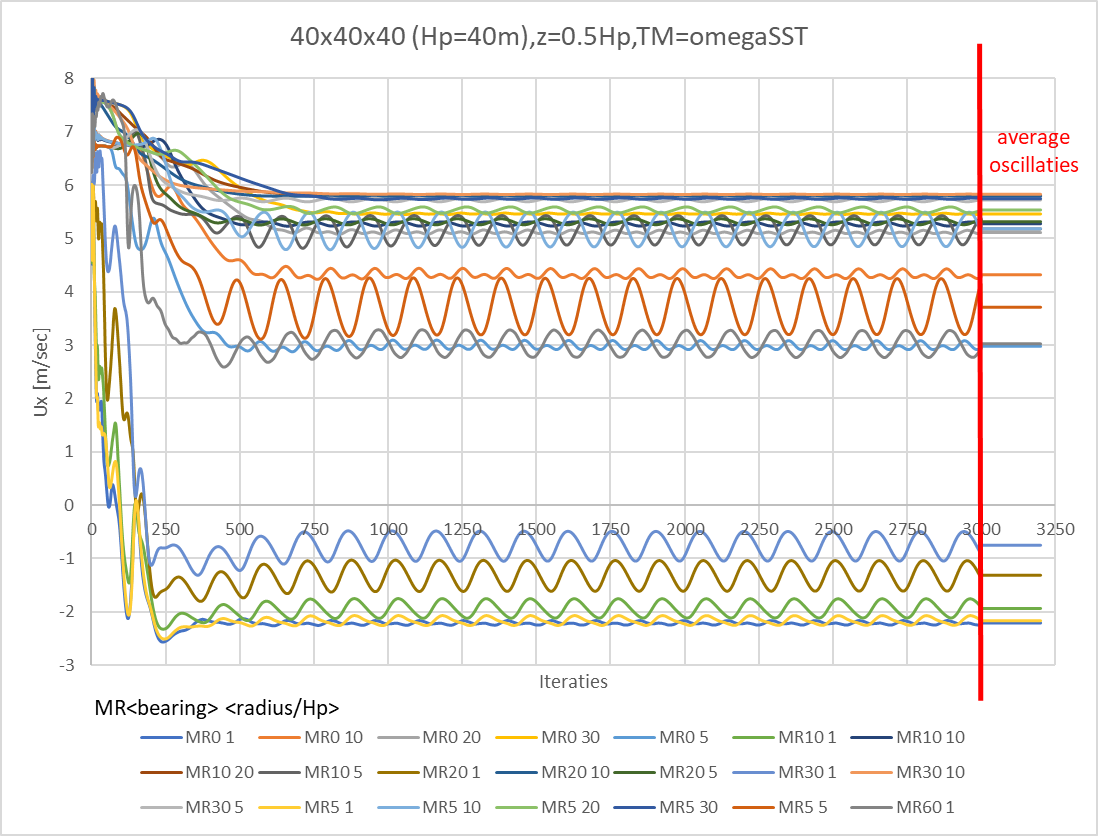

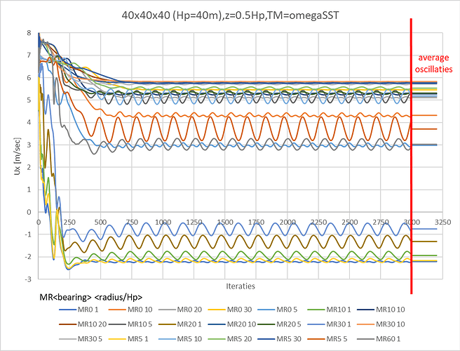

So if I use k-omegaSST, I get oscillations in these Probe point plots, e.g.:

None of these give a different behavoir: in someway convergance but with oscillations (not damping out).
Thirdly I read that one could average the oscillating curve (see this in above graph after 3000 iterations). Is this true?
Any advice how to handle these oscillations? Thanks for your help.
