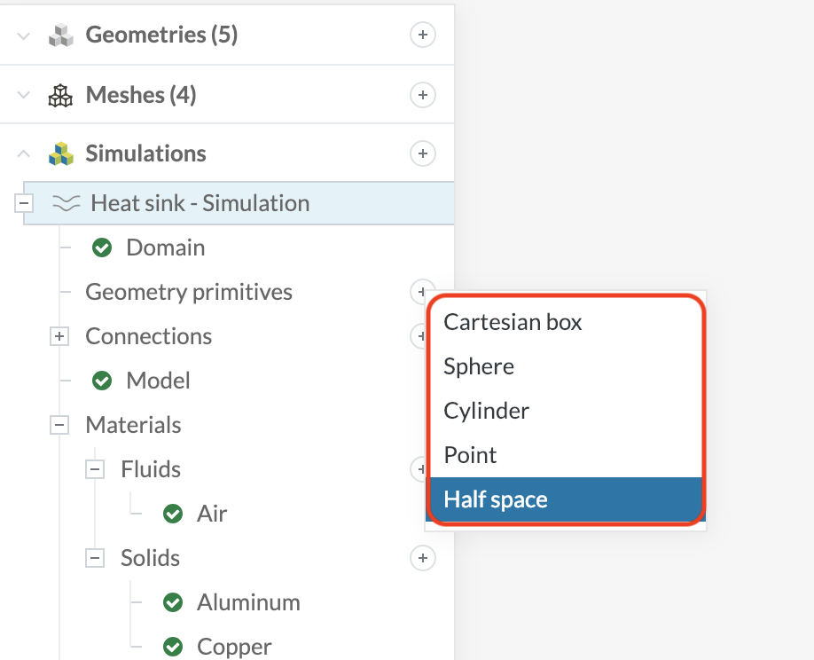

how do i add a geometry primitive? i am poking around in the analysis options, but i just don’t see how or where to do this.

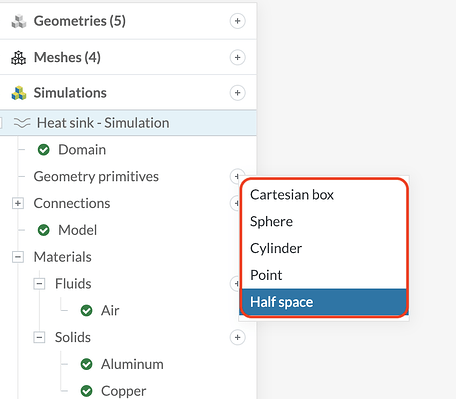

Hi George!
There you go :slight_smile:
Let me know if you have any further questions. Edit: Of course you choose the Point here - the focus should be on the red box :wink:
