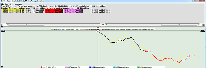

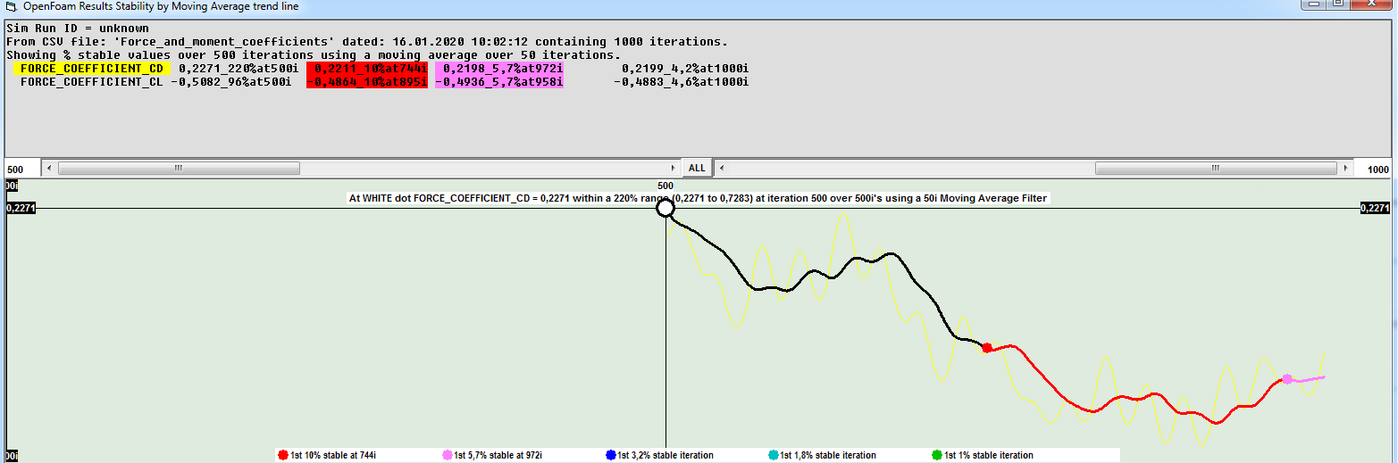

Success!! This is the plot from the full car simulation
  • 1 layer BL at 3.4mm
  • 1000 iterations - it seems i should have it run longer, it did not reach 1% stability

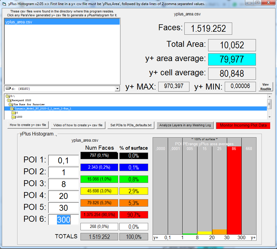

The Y+ histogram log is still running but so far it looks good. Ill update the final histogram when all faces are accounted for.
Edit here is the final result - 30mb file, had to wait a bit
