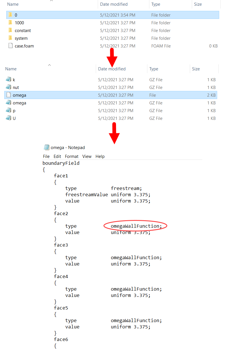

For the k-w SST model, which wall function actually used in Simscale? Do you have any documentation that maps which wall function is used foreach model in the Simscale framework?

Briefly going over the questions:
  • I believe this is not explicitly in the docs, but it’s possible to check. By downloading a simulation result, the type of wall function is going to be in the result sets. For instance:
So yes, you are correct: omegaWallFunction is used for omega.
  • You are also correct about the blended wall function statement. This wall function contains a built-in mechanism to switch the wall treatment, based on the local y+.
  • Yes, there is a way to obtain the OpenFOAM inputs, by downloading the result set. Naturally some of the input may be custom/different from the OpenFOAM implementations.
