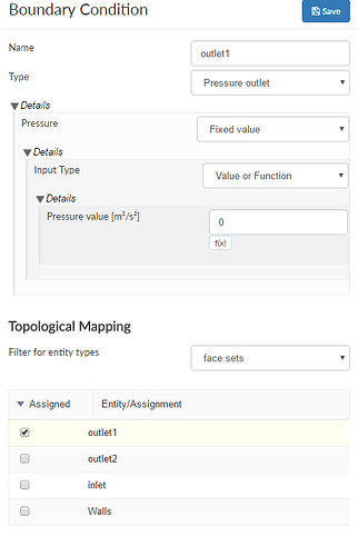

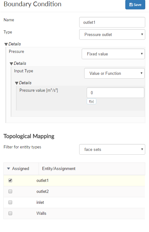

For the outlet conditions, I’d recommend using a zero pressure outlet:

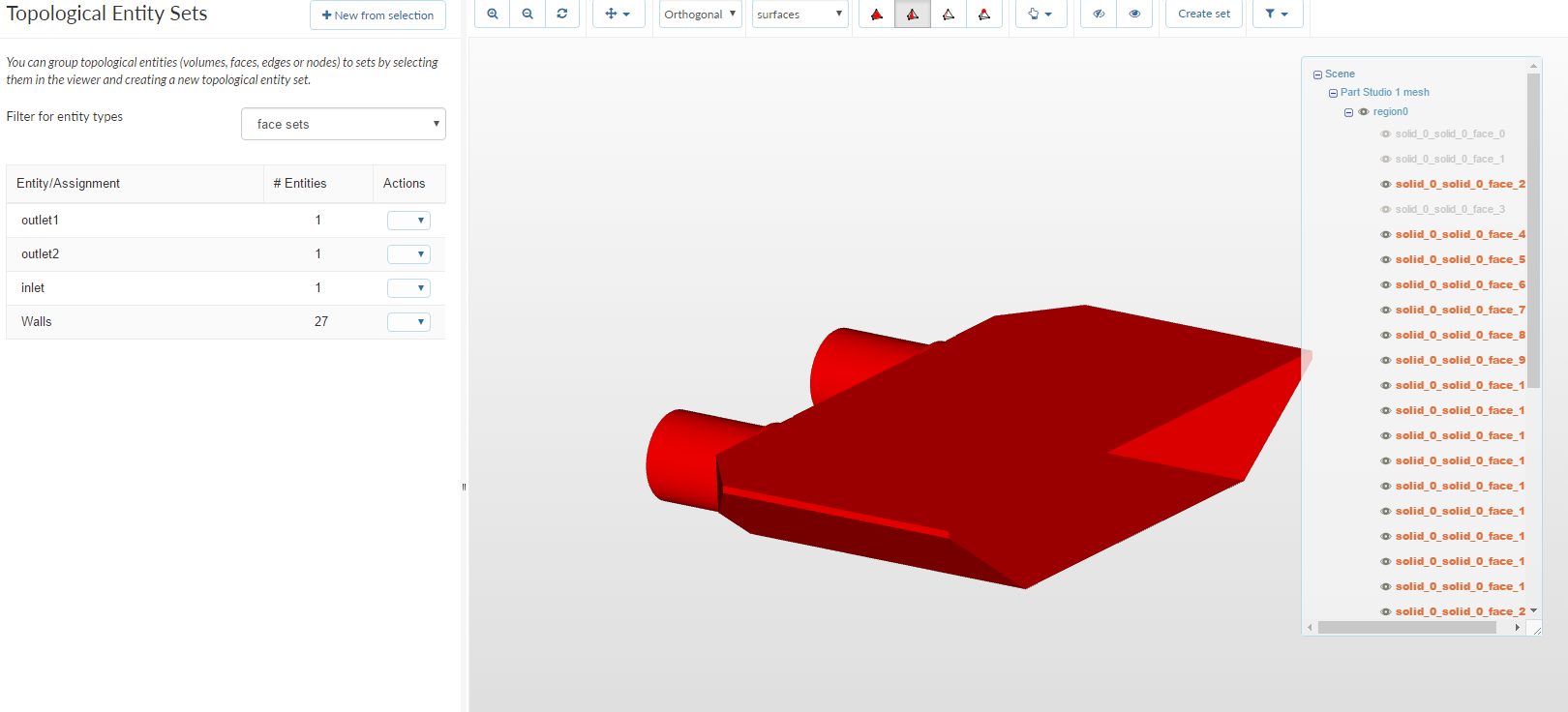

Also had a look at your Topo entity sets and your missing some wall faces (I assume they are quite small). I think there should be 27.
