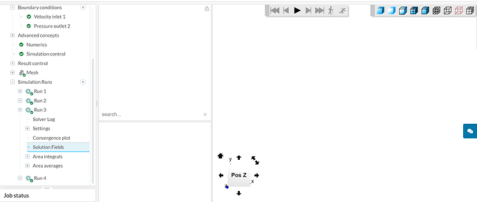

When I click on ‘Solution Fields’ I get the following screen and nothing every loads. I’ve checked on multiple projects and on multiple computers.
Checking this @jcol. Getting back to you ASAP!
Since I first asked the question my ability to view Solution Fields came back, but then went away again.

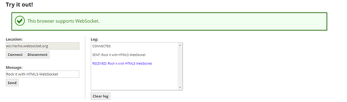

Something is likely blocking the websocket connection.
Potential problem candidates:
- Network (especially corporate ones can do that)
- Antivirus
- Firewall
Can you test if this works: https://www.websocket.org/echo.html, connecting then sending a dummy message.
Keep me posted!
