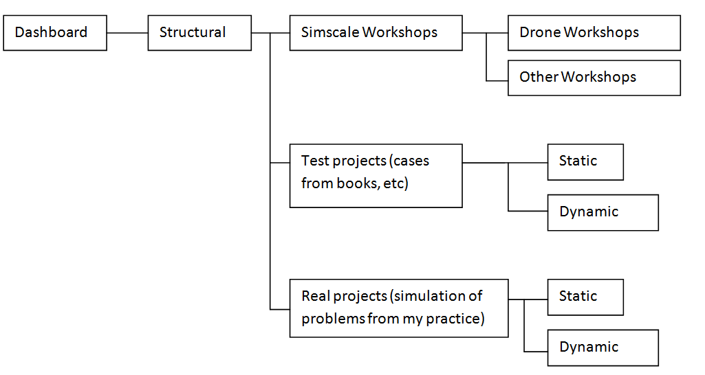

I also prefer fast and advanced search and filtering. If there are folders, I will use them for systematizing and finding projects fast. I would use the following structure:

Hi @atanas_kuzev,
excellent - thanks for elaborating, got it! I’ll soon open up a thread for a discussion of folders for project asset management. I’ll post it here then.
