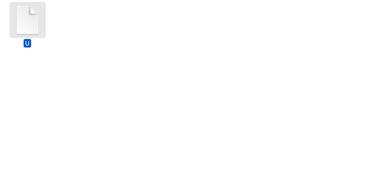

Hi simscalers! I wanted to use preview to view my results but when I download the solution field on my MacBook and open it the zip folder does not have the case.foam or case.prv. Anyone know why this would be the case?
Hi there, could you upload a screenshot showing the containing of the folder, please?

If this is literally all that you have in the entire solution folder that was downloaded (i.e. no constant folder, no system folder, etc), then there is likely an issue somewhere.
For testing purposes, do you happen to have a machine with Linux or Windows to try downloading the result files?
IT FIXED IT THANK YOU! On my MacBook it automatically opens the file. This solves the problem: Disable automatic unzipping by Safari: Go to Safari - General and disable “Open safe files after downloading.”
